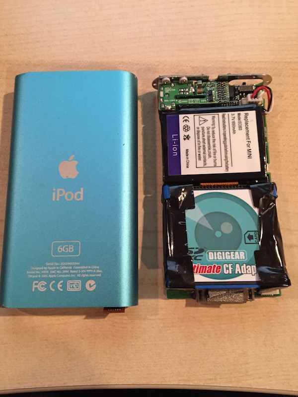

You'll have to keep us up to date on your upgrade. I just picked up a compact flash adapter and a 64 GB SD card in addition to the battery so I can upgrade my mini.

I'll have to be really careful this time since last time I killed my iPod :p
Any tips on taking it apart? I've used the tutorials and it seems to go right but I messed my iPod up somewhere along the way.

The trickiest part is disconnecting the click wheel from the motherboard. You want to use a small flat screwdriver from the side and only pry on the connector, not the cable.
I finally finished my battery and 64GB CF upgrade. I had a few issues with the iPod self ejecting while I was trying to sync my music, but overall, it seems to be working well.
