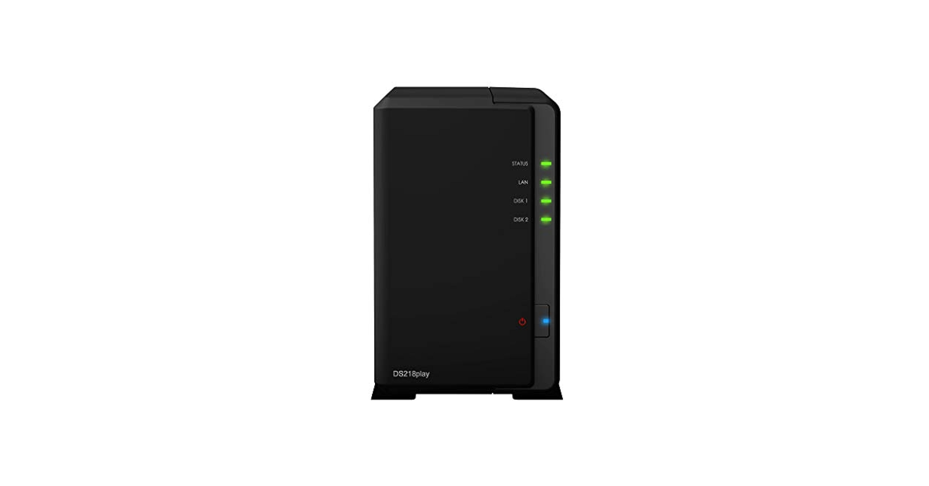

The cheapest Mac mini is $599 then you need an external drive.
This Synology has is also $599 with 2TB SSDs. The NAS will also work and a Time Machine destination for the computers. You will need a larger drives for that.
Synology DiskStation DS218play Mini​
It features 4K Multimedia Server Capabilities, Desktop and Mobile Device Backup, File Server and Management, Video Station, Audio Station, Photo Station, Easy File Access with QuickConnect
It's as easy to use as a computer. You just logon to the device and it looks like a computer desktop. It really is much better that it used to be.
