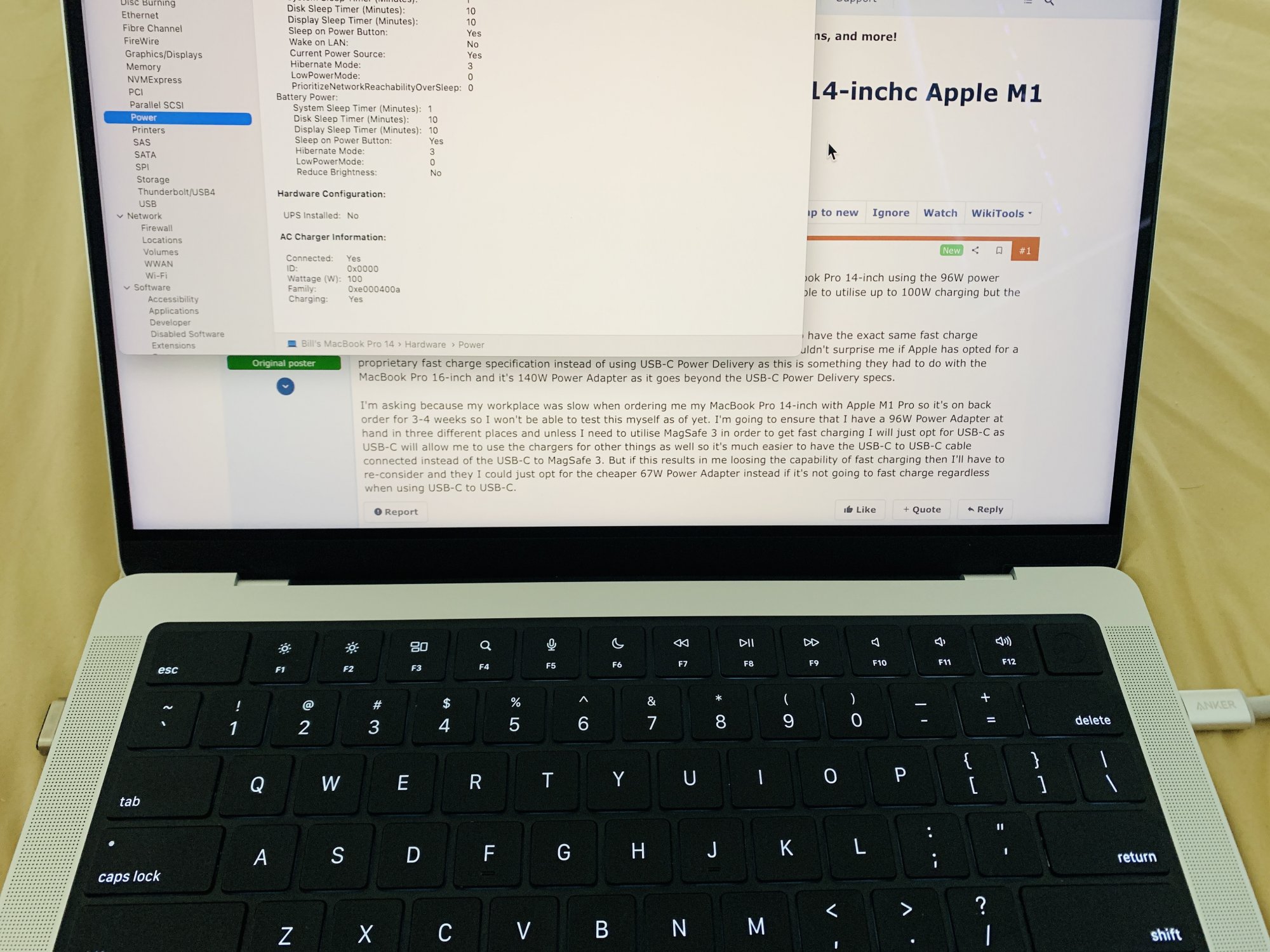

Have anyone tested if they are able to get the same charging speeds on their MacBook Pro 14-inch using the 96W power adapter via USB-C to USB-C? USB-C and USB-C Power Delivery is supposed to be able to utilise up to 100W charging but the closer you get to that 100W limit the worse it get it might seem.
This should mean that the MacBook Pro 14-inch with Apple M1 Pro should be able to have the exact same fast charge behaviour using MagSafe 3 and USB-C for charging. Have anyone tested this? It wouldn't surprise me if Apple has opted for a proprietary fast charge specification instead of using USB-C Power Delivery as this is something they had to do with the MacBook Pro 16-inch and it's 140W Power Adapter as it goes beyond the USB-C Power Delivery specs.
I'm asking because my workplace was slow when ordering me my MacBook Pro 14-inch with Apple M1 Pro so it's on back order for 3-4 weeks so I won't be able to test this myself as of yet. I'm going to ensure that I have a 96W Power Adapter at hand in three different places and unless I need to utilise MagSafe 3 in order to get fast charging I will just opt for USB-C as USB-C will allow me to use the chargers for other things as well so it's much easier to have the USB-C to USB-C cable connected instead of the USB-C to MagSafe 3. But if this results in me loosing the capability of fast charging then I'll have to re-consider and they I could just opt for the cheaper 67W Power Adapter instead if it's not going to fast charge regardless when using USB-C to USB-C.

Yep. It works. Full 100W charging.
0% to 50% is indeed around 30 minutes like this.
50% to 100% takes about 1 extra hour.
Charging with 65W USB-C charger takes 3 hours total.
I'm also not using Apple's provided charger, but the smaller Aukey Omnia 100W brick.
This is actually one of the major reasons I didn't go with 16". 14" with smaller 100W charging brick and being able to fast charge on both sides of the device without MagSafe is much more convenient for me overall.

I can also confirm fast charge on 14” works with or without MagSafe as long as your type-C PD charger outputs somewhere 90W (about 18V 5A)
On a 96W charger I got from an Intel 16”, negotiated 94W and initial draw 70+ watts
I also got a Satechi 108W, negotiated 90W and also draws about 70W
Both had my base MBP idle but not sleeping, just charging with the display mostly off.
30 minute indeed charged from 24% to 74%, then it slows down almost taking double the time to top up.
The 67W charger that came with it seems to takes almost 2 times to charge, but as for using the MBP intensely I don’t think the 67W would lose you charge just that the 90W+ will give you more headroom.

Yeah, I can confirm... 65W can keep the device charged up even under intensive use. But this is for M1 Pro. I'd suspect M1 Max under intensive use may throttle a 65W charger.
