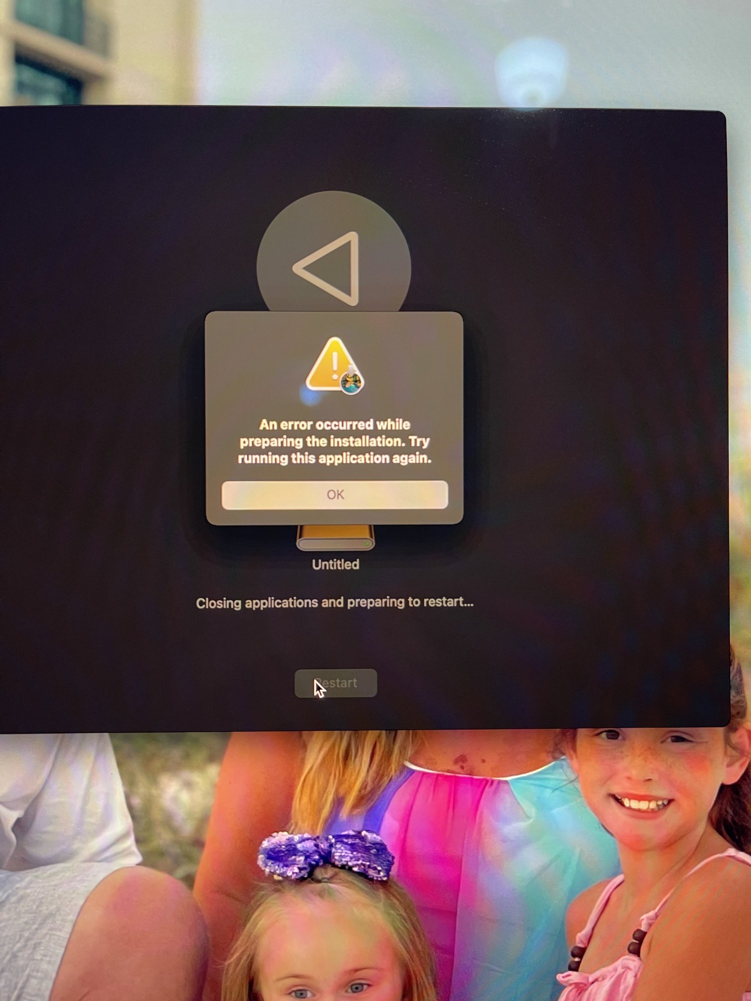

So far I’m unable to install the Mac OS into this ssd. Every time I get to the end where the Mac gets ready to reset for the install I get this error. I’ve followed all the steps and even tried doing it with the Mac in safe mode but I always get this error. Any ideas?
