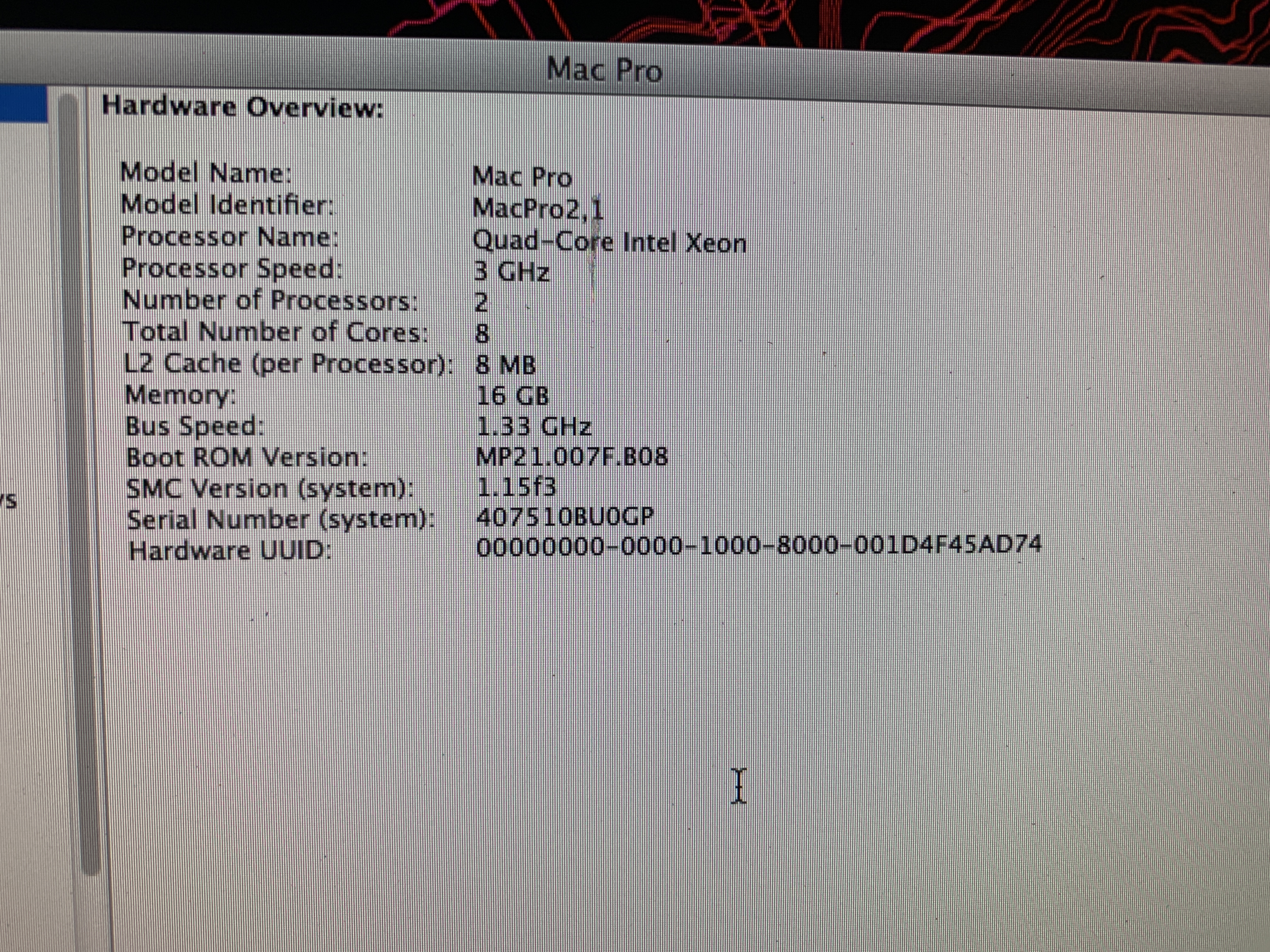

I am trying to start a YouTube channel and I want to know if my Mac Pro can edit and export a 10 minute 1080p video with relative ease
You’ll be totally fine with it. Transcode the videos to prores first and it’ll fly.
i used to use mpegstreamclip to make proxys
http://www.squared5.com/
The 8-core 2007 Mac Pro should be able to handle 1080p w/o problem. You can probably even work in H.264 natively for some of it (w/o having to transcode), depending on the bitrate and compression, and how complex your edits get. The most efficient way to do that would be Final Cut Pro X, which can automatically transcode to ProRes in the background seamlessly if you determine you need to do that. Looks like you've edited it out, but if you are indeed going to 10.11, you should be able to run FCPX 10.3.x, which is not the latest, but still very good and does most of what 10.4.x does. One thing you'll need to do tho is to upgrade to a supported video card for FCPX. A Radeon HD5770 would work well and be a good, inexpensive choice.
