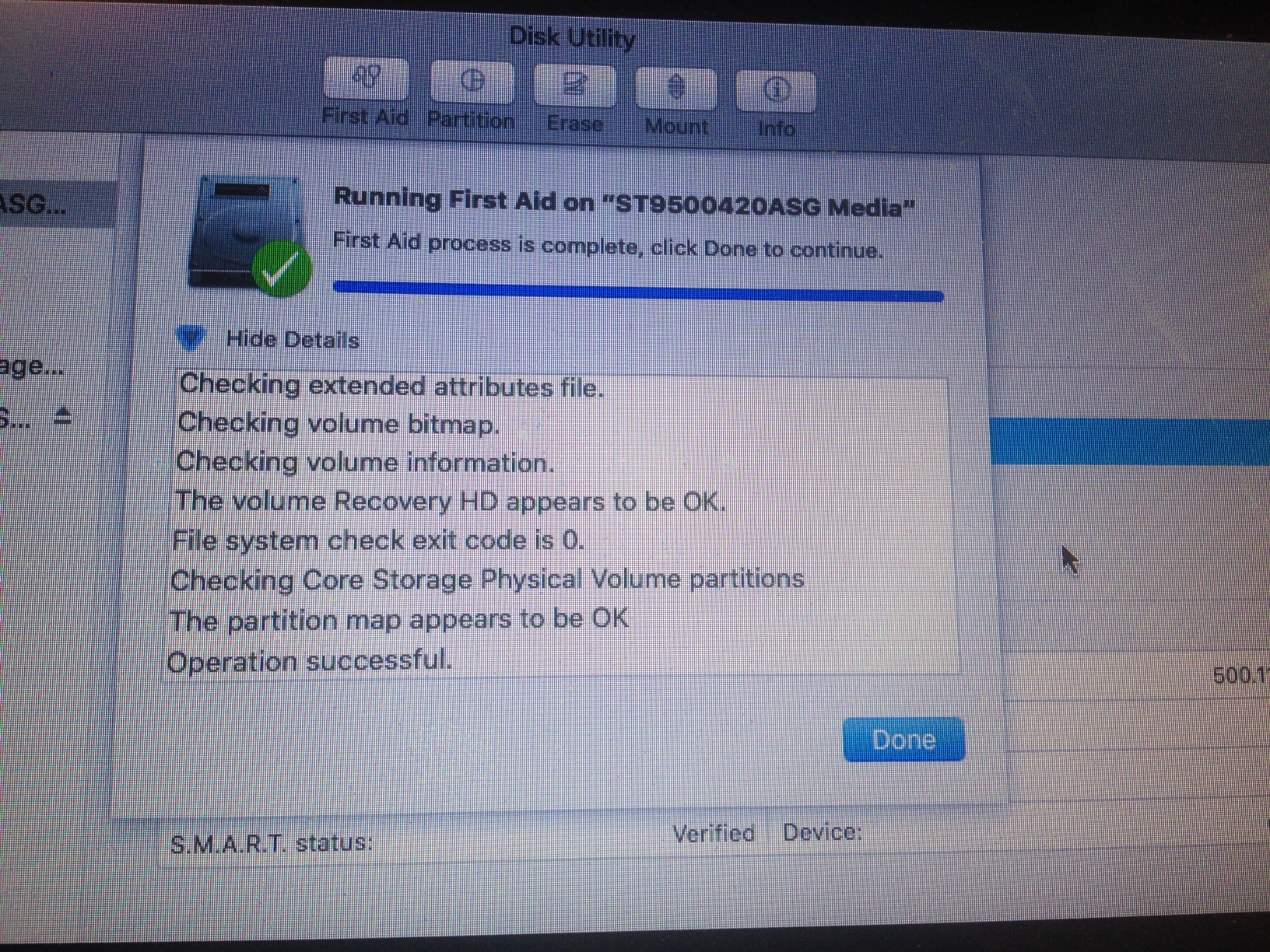

When I choose this option, the disks and partition are grayed out. I was able to try to do first aid on the internal disk once and the attached image shows the results.

Hard drives die. All of them. It's a matter of when, not if. Sounds like yours just kicked the bucket. The WD drive you mentioned would work. Any 2.5" SATA drive 9.5mm or under in height will work.
