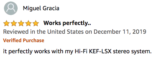

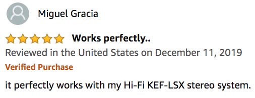

I just noticed this brief Amazon product review for the Reiyin DA3:

They Reiyin DA3 is USB 2.0. Is it fast enough to deliver HD audio?
192kHz = 192,000 samples/second. 24-bit = 3 bytes. Sample rate * sample size = Data rate per second.
So 192,000 samples/sec * 3 bytes ~= 576,000 bytes per second.
This is less than 1MB/sec. Less than 4.4 Mb/sec. USB 2.0 maxes out at 480 Mb/sec (on paper). There's more than enough bandwidth.
If all you want is optical out for the KEFs, this thing is fine, and probably what I'd recommend in your case.
I'd really only recommend a full DAC if you want to use it as a DAC. Otherwise, you're paying a decent chunk of change for a DAC chip just to pull the optical or coax digital outputs that don't need it.

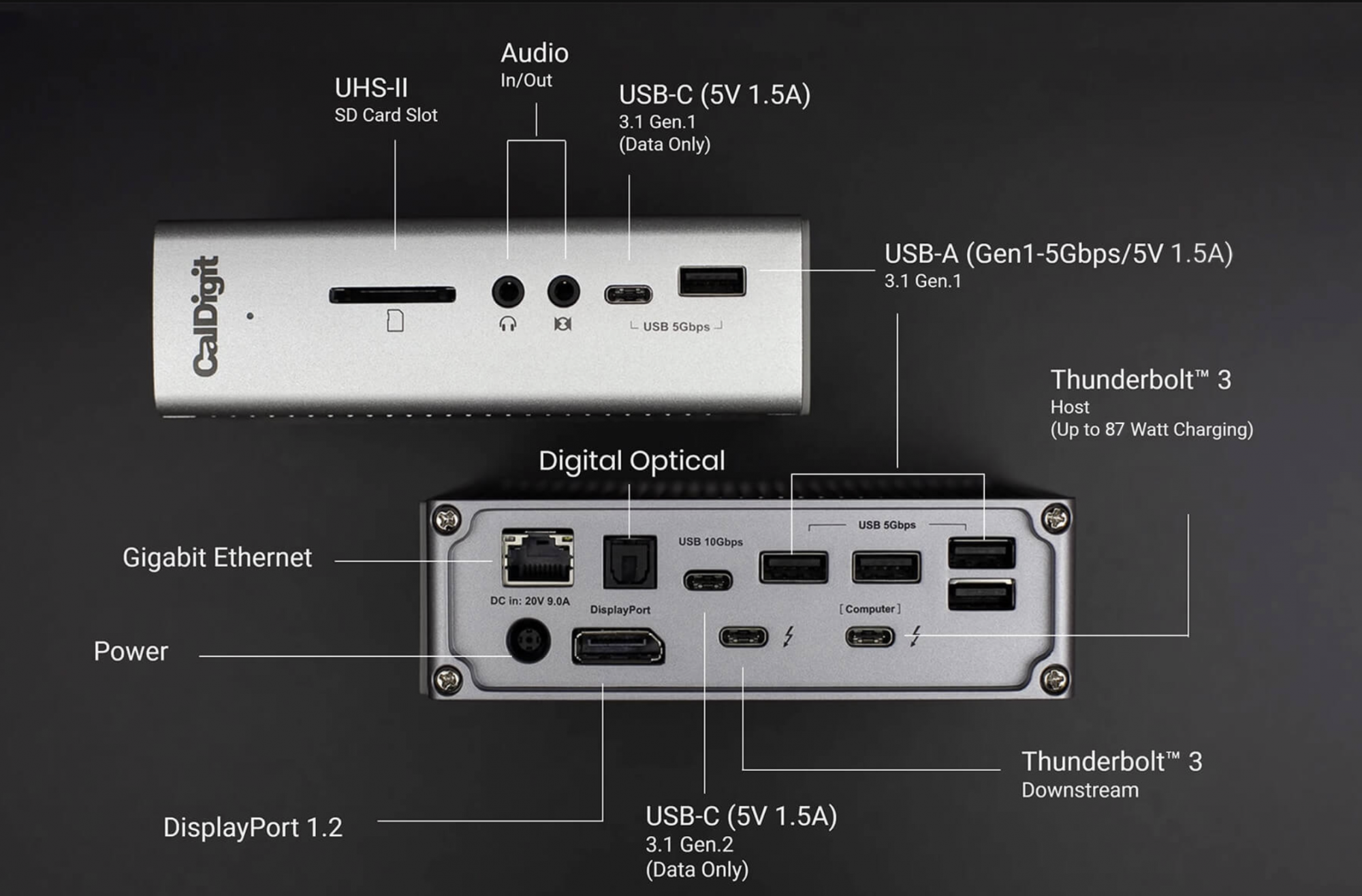

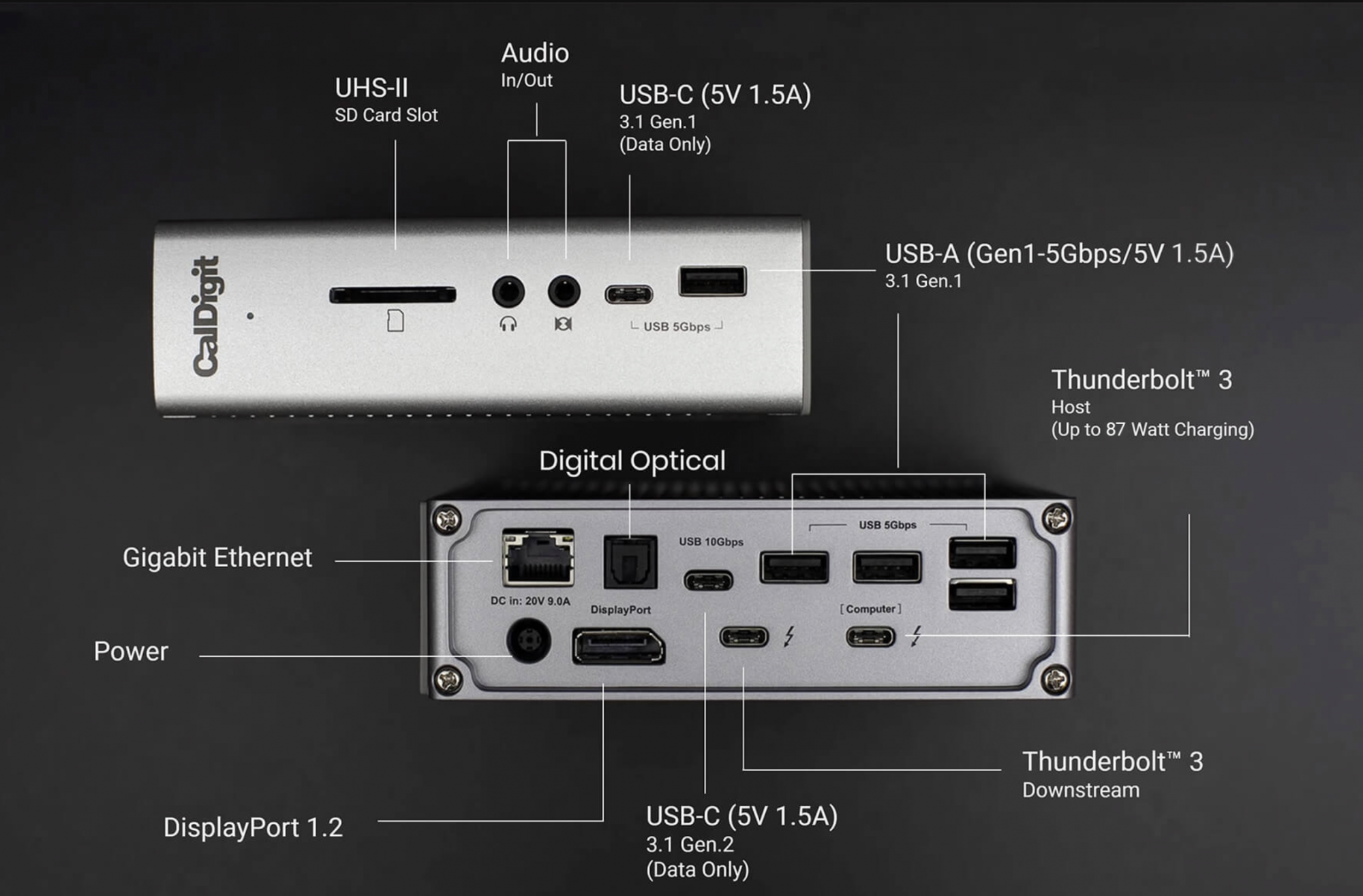

Not the cheapest but the easiest solution is the Caldigit TS3 Plus. Native Digital Optical/Toslink.
