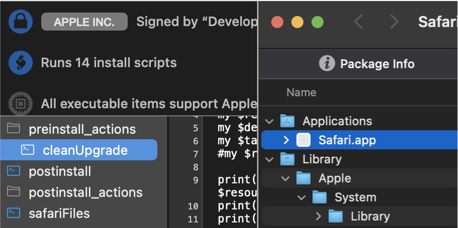

You can hit Cmd + I with the installer open, it will show you what is going to be installed and where (if the devs are being fair and not trying to hide anything, i.e. it's possible to ostensibly install nothing, and then actually install the app in a post install script).
