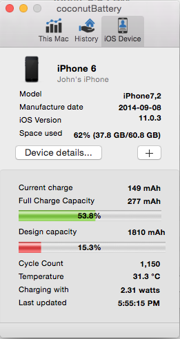

As far as I know, there is no iOS app that will give you that level of information (unless you jailbreak). However, you can install programs like coconutBattery (for MacOS) or 3uTools (for Windows) that will tell you how your battery compares to it's theoretical design capacity. Here's a screenshot for reference.
If your battery is below 70% of its design capacity, then it will need to be changed. Anything lower than 50-60% will usually struggle to maintain power to the device and it will fluctuate like you are describing.

Thanks for info thats what I was looking for. I downloaded CoconutBattery and heres what it shows, it looks like it's in very bad shape right at 15 percent? Sheesh also the cycle count at over 1k seems like a crap load.

Yeah, 15% is as bad as I have seen (other than a truly dead battery). You can get very good quality replacement batteries at iFixit.
