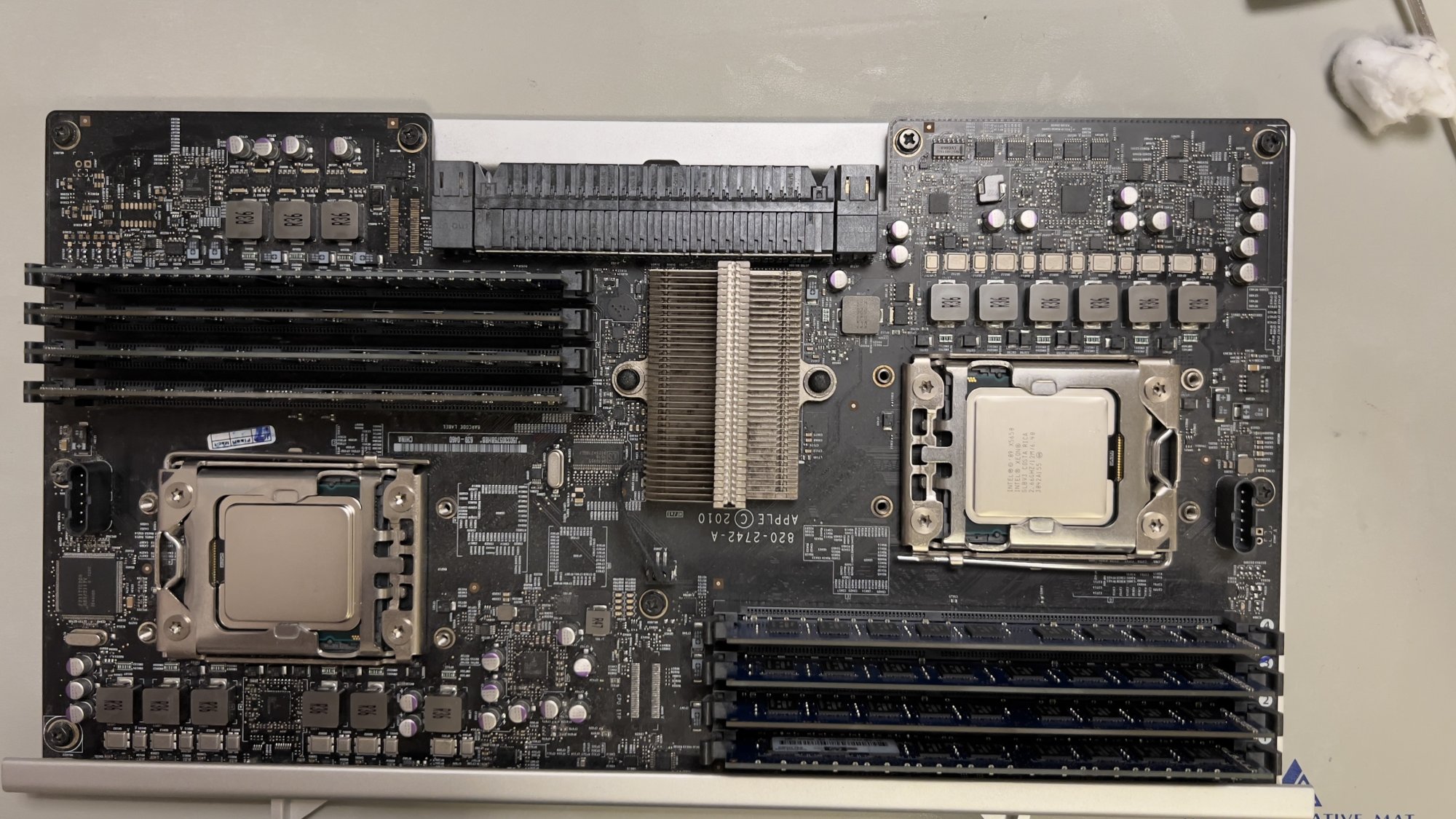

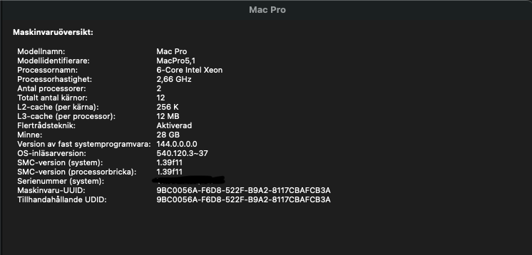

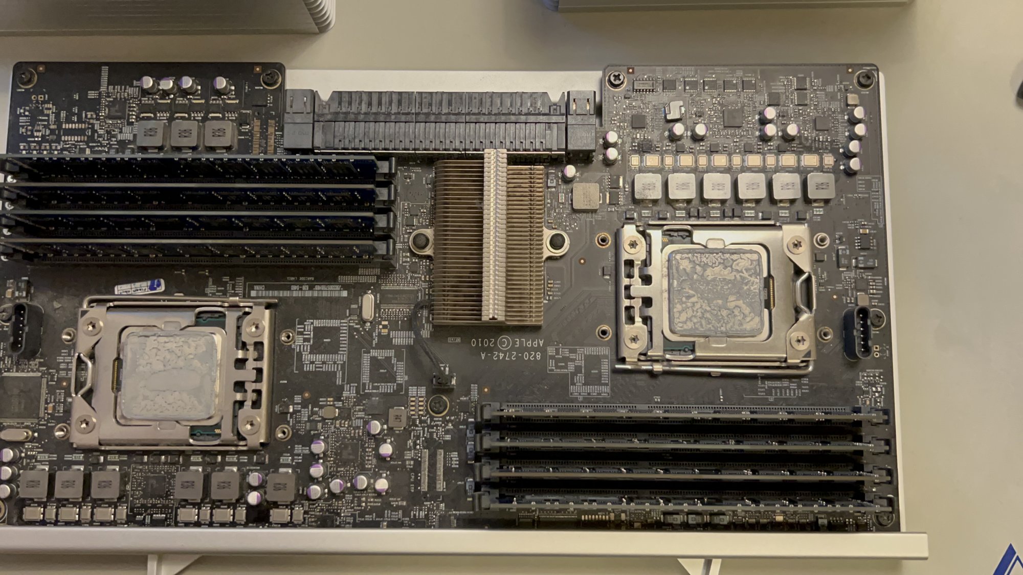

I have now changed both XEON to X5650, I used a thermal paste named Plexgear MX-990 Carbon Freeze. The computer overall is cooler now too. it took me almost 3 hours to do this, I cleaned the board carefully with ISP, the thermal stripe I did not change, looked fine but I had a little of the cooling paste on it. the previous owner seem to have fixed the issue with the vinyl washers, everything looked fine. Now I can't get the RAM to run in 1333, did a NVRAM reset, also a SMC reset. I guess I have to check all modules, but if I remember correct I bought only the Hynix 10600E. Will check those tomorrow.

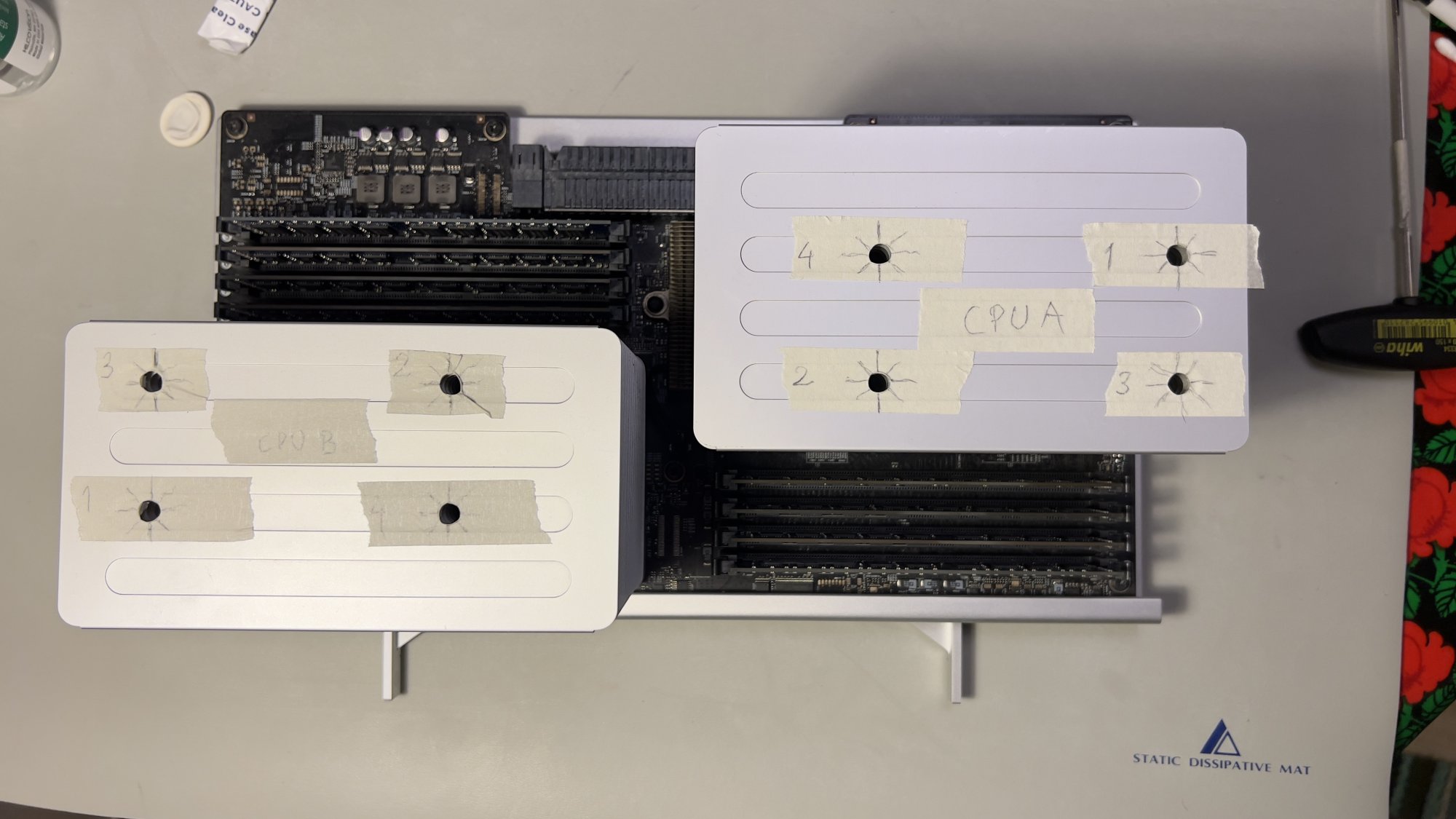

Anyway my way to do this was from the technical manual, but also marked the holes with paper-tape, i marked the T-Hexwrench too. Then i start loose carefully each one of them (hole 1 at bottom left then 2 top right and so on, just a quarter at a time while i held the sink with my left hand. Halfways i turned a each one 360 degrees, and still holding the sink with left hand. Nr 1 and 4 loosed first, and then 2 and 3. Now i felt the sink was loose and only the connector was holding it. So with both hands i lifted the sink carefully straight up.
Reassembling was harder, i needed much light, and sitting on my knee i aligned the sink with the holes, and the connector. Then carefully i just let the sink go in place.
When tightening i hold the sink with my left hand again, and this time i put a tiny pressure upwards, needed to be extremely careful, then each one max a quarter, i noticed the sink was start move up and down, and there i realized the extreme importance to a exact a quarter in correct order, sometimes i tight one of them little more, so i needed to loosen little. Then i checked with bubble level the sink position. In my case when the first one came to stop, hole number 4, number 1 did afterwards too, and the rest aswell due to correct order when tightening. The technical manual from Apple said “when comes to fingertight, continue 1/4 more. In my case that was impossible, the bolts wont move more. Dunno if I done something wrong, but it was impossible to tighten more.

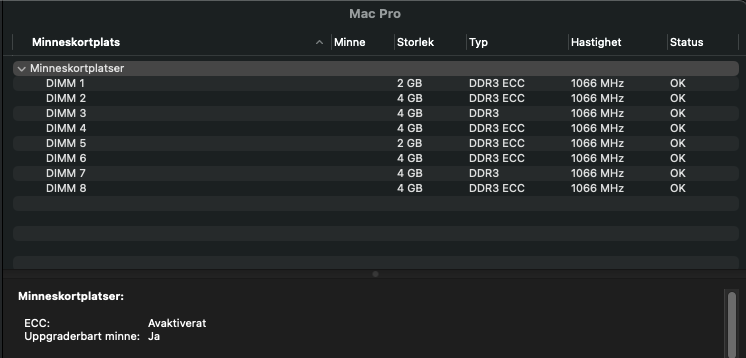

I checked my RAM, and the two Hynix 4GB that were non ECC i removed and replaced with two 2GB Hynix with ECC, that resolved the problem and now i have 1333. My Mac is extremely much faster now, it’s like a new computer 😁. So in RAM i have total 28GB. I wonder if it’s necessary to upgrade more RAM? I can buy a OWC kit 64GB for about 90€ here in Sweden. I would like to start converting high res video, and i work a lot in Photoshop. I have the GTX 680 2GB card, i think i’m done with upgrades, maybe more RAM. I will boot into High Sierra today and do a benchmark, main OS i use is Monterey maybe the Mac runs faster in HS
