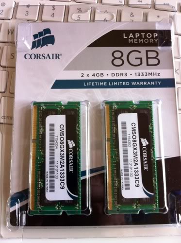

I purchased a 2011 Mac Mini yesterday with the i5 and 500GB. I immediately upgraded it to a 7200 750GB HD. I also changed it's memory from the measly 2GB to 8GB using brand new corsair memory purchased off amazon. For some reason at random times using the computer I get the black screen of death asking me to restart the computer. I have tried to narrow it down by only putting 1 stick of memory at the time to see if it does this as it can be a faulty memory stick but since it happens at different times it's difficult to narrow it down. What do you guys recommend?
Thanks
This is the memory

HDD problems rarely lock up the system like that so I would really focus on the RAM here. You may have to really work your machine to trigger this problem or better yet you could run a memtest86 (see here). I assume you also checked the temperatures and the fan?
Agreed. I've seen this problem with bad RAM before. I'd start there for sure.
I had the same issue with the same ram. I took it out and put the original ram back in. No problems. I sent the Corsair back to Amazon and am awaiting Crucial replacement.
I've read many times where people have trouble with RAM brands like Corsair and other PC-centric "performance" RAM.
I personally always stick to RAM specifically confirmed to be Mac model-compatible. Crucial (via their auto-configuration system) or OWC are the two that I will typically use. So far, after 15 years, I've never had a bad batch from either of them.

i've been using that same corsair ram for weeks now and have not had a single kernel panic with the mini server. i assume you were careful taking the modules out of the horrendously tight packaging.
Most likely kernal panics (?) due to bad ram. Run memtest or Rember to see if it is the ram.
I also would put kingston on that list. Used 2x2 kingston sticks on my 08 computer and recently 2x4 on my 11 computer and works beautifully.
Those corsairs disks had too many negative reviews on amazon for my taste.
I've had bad experiences with Corsair RAM in Macs. I've had good success with Patriot RAM in Macs and it is usually very cheap. Corsair has been great in all the PCs I build though - I'm not sure why they have problems in Macs.
