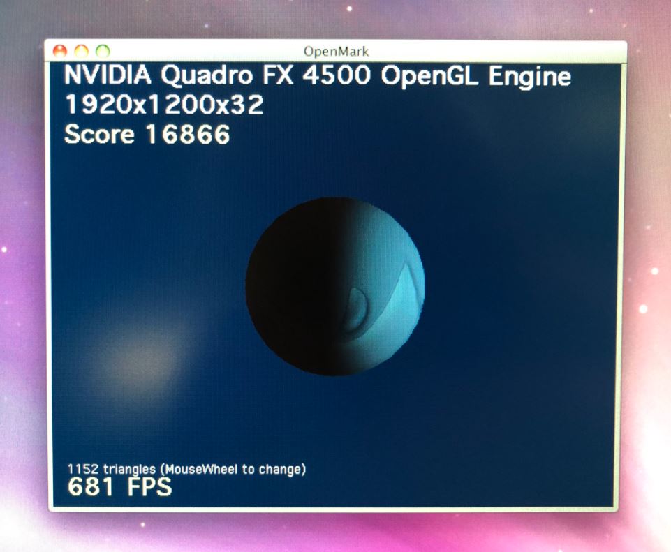

Try running OpenMark and compare your results:
I was very underwhelmed when I had a FX4500 in my Quad - I wasn't using it for games but it offered no apparent advantage over my 6600.
Curious. Seems to be in line with expectations. Was watching the power monitor on the G5 and it went from around 135W to around 205W. Not sure it that would be the CPU or the GPU. Thanks for the suggestion. I'm no closer to why but at least I know the card seems to be OK.
