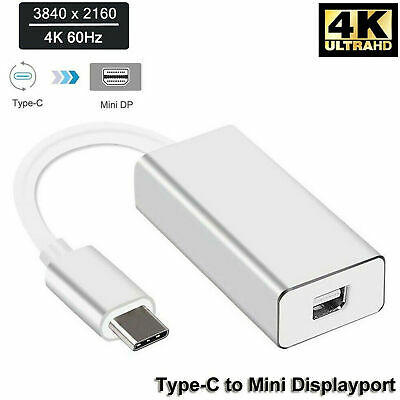

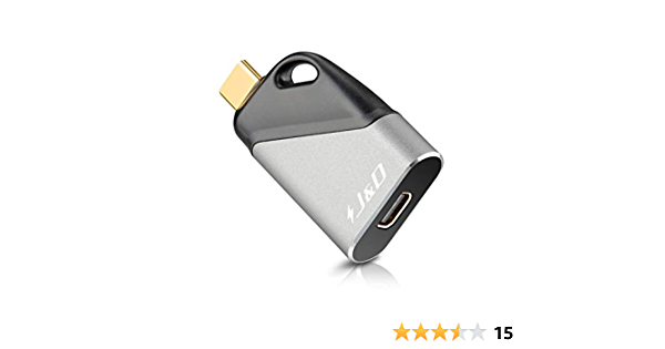

You need an adapter from USB-C (male) to Mini DisplayPort (female).
