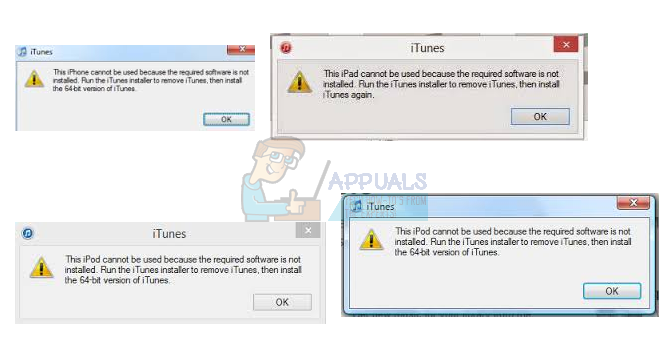

I am using the IPP 10.5 with the last iPADOs. I had the 12.6.5.3 version from iTunes (the last one which allow moving back and forth IPAs from the App Store into the device, backups you made), but when I try now it says the following:
"The required software is not installed."
This link seems to suggest a workaround but I am afraid of doing something and installing a newer version. I don't want to lose the IPA/App Store from iTunes.

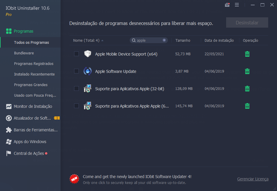

I'll try today this Windows program:
Later I'll post here if it worked.
P.S. After removing iTunes I saw these here:
It must be them.
It worked! After removing the traces I mentioned before then the 12.6.5.3 recognized the iPAD again after a reinstall.
