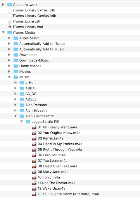

If you look at your external library your media files should be stores in iTunes>iTunes Media>Music> see below as an example.

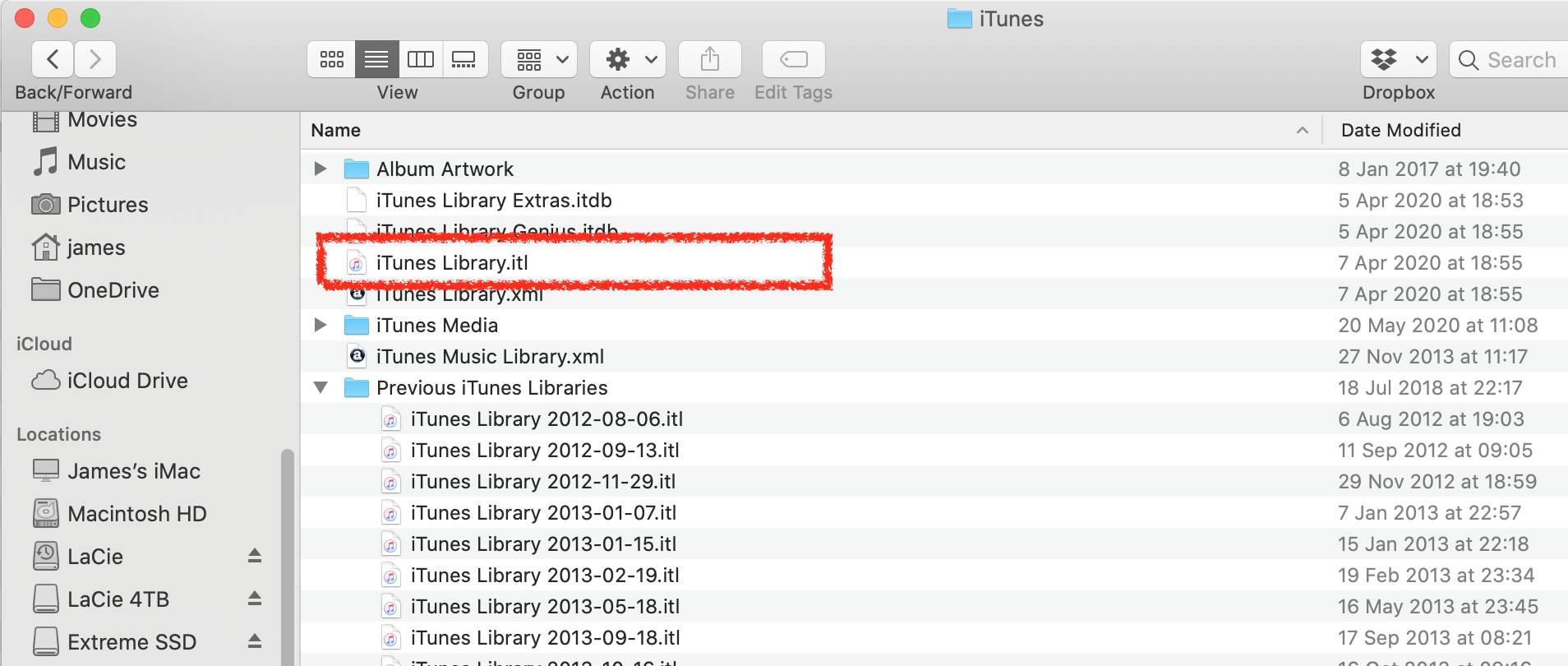

Your current library should not be in 'Previous iTunes Libraries' it should be in the root of your iTunes folder.
I have my iTunes Library on an external disk and this is what it looks like.
If you don't see your library database here then it must be somewhere else. At a guess it is probably in your Music Folder on your Old Mac.
If your iTunes Library Database was on your old Mac and you can't access it, then you will need to build a new Library.
When you start iTunes hit the Alt key at the same time and choose create new Library. I created a short screencast tutorial below how you can import your music to your new Library. The only downside is you will lose your playlists, if you have any created.
