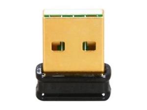

I use this tiny USB wi/fi adapter from Edimax, works well enough at wireless "n" speeds and takes up no space at all plugged into a rear usb port.
Since I purchased mine Edimax has come out with a newer version that supports wireless AC.
https://www.ebay.com/itm/EDIMAX-EW-...475375?hash=item467f7af56f:g:odgAAOSwnpBbNDf6

So thanks for all the replies. The USB Wi-fi was very tempting but I opened up and saw the 2 antennas wires in good condition still with plastic on the tips and I watched a YouTube video so I'm giving the internal PCI-E card a go. But thanks for recommending the Edimax I have it bookmarked for future endeavours!
