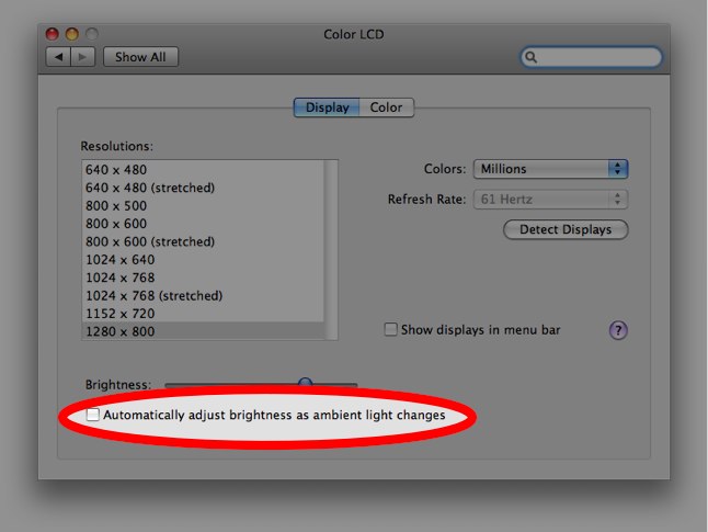

I did a brief search through the MBA forum... I'm not sure if I'm having the same exact issue (or if there are multiple similar backlit KB issues).
My screen (and KB) were crazily oversensitive to the ambient light. So I unchecked Sys Prefs> Displays> Auto adjust brightness (like so):

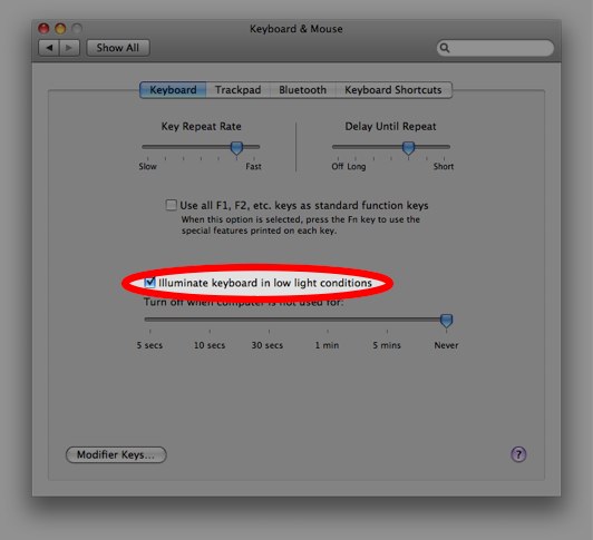

But still wanting the KB to remain illuminated I made sure to keep Sys Prefs> Keyboard & Mouse> Illuminate KB checked (like so):
So, the display no longer twitches out on me. However... the KB backlighting is so aggravating! It was way too bright (sunlit room) and so I manually turned it down a couple of notches. After a few minutes-- it was off completely. I manually turned it back on. Few minutes later, completely off. (Mind you, the lighting hadn't changed at all.) Again, I manually turned it back on only to have it completely turn off on its own again.
Is this the issue y'all are experiencing?
If so.. ARGH! :D I'm so bummed! I was really really looking forward to this feature, and am disappointed that it's not quite working out as I'd hoped.
I've tried every type of iteration and calibration but it all leads to plain frustration!
