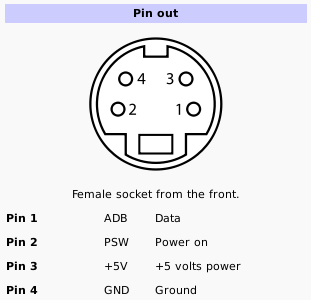

I tested the Apple Bus pins, they are giving 5.0 ~ 5.8V, excluding gnd.
with the multimeter, in continuity scale, pins 3 and 4 beep with a low resistance (009) when the power supply is plugged into the motherboard. when I remove it, the resistance increases (~330) and the multimeter does not beep.
I also don't know if this is the best way to identify an error, I don't have much skill in electronics.
