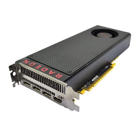

Your friend will need to obtain an AMD card with modern metal support to run Mojave .
I recommend a blower type RX 480 with 8GB video memory to run Mojave in your Mac .
It looks like this :
You will not have any CUDA support with an AMD card .

You should stop recommending this the way you do.
You know that Dell workstation GPUs that need more than 75W from the PCIe slot are identical of the photo and Dell RX 480/580 GPUs are know to damage the Mac Pro PCIe slot.
A user that see the photo/read the way you wrote would buy a Dell GPU since eBay has lots of it and burn the backplane inadvertently.

Au contraire , the blower type RX 480 is a conservative choice in term of safety installed in these machines , Alex .
All of the RX 480 blower type cards I have installed in cMPs that look like the picture , whether made by Dell or Radeon branded , stay within the power safety ranges even when at full System load . Specifically , the PCIe slot will not need to provide more than 65 W and the single mini six pin PCIe booster on the logic board will not need to provide more than the 75 W it is safely rated for .
I watch this like a hawk , Alex , with all my builds .
I admit , it's unusual for a graphics card to pull more than 30 or so Watts from the PCIe slot , but the slot is safely rated for 75 W .
And there are a lot of advantages to using this card over the officially recommended RX 580 .

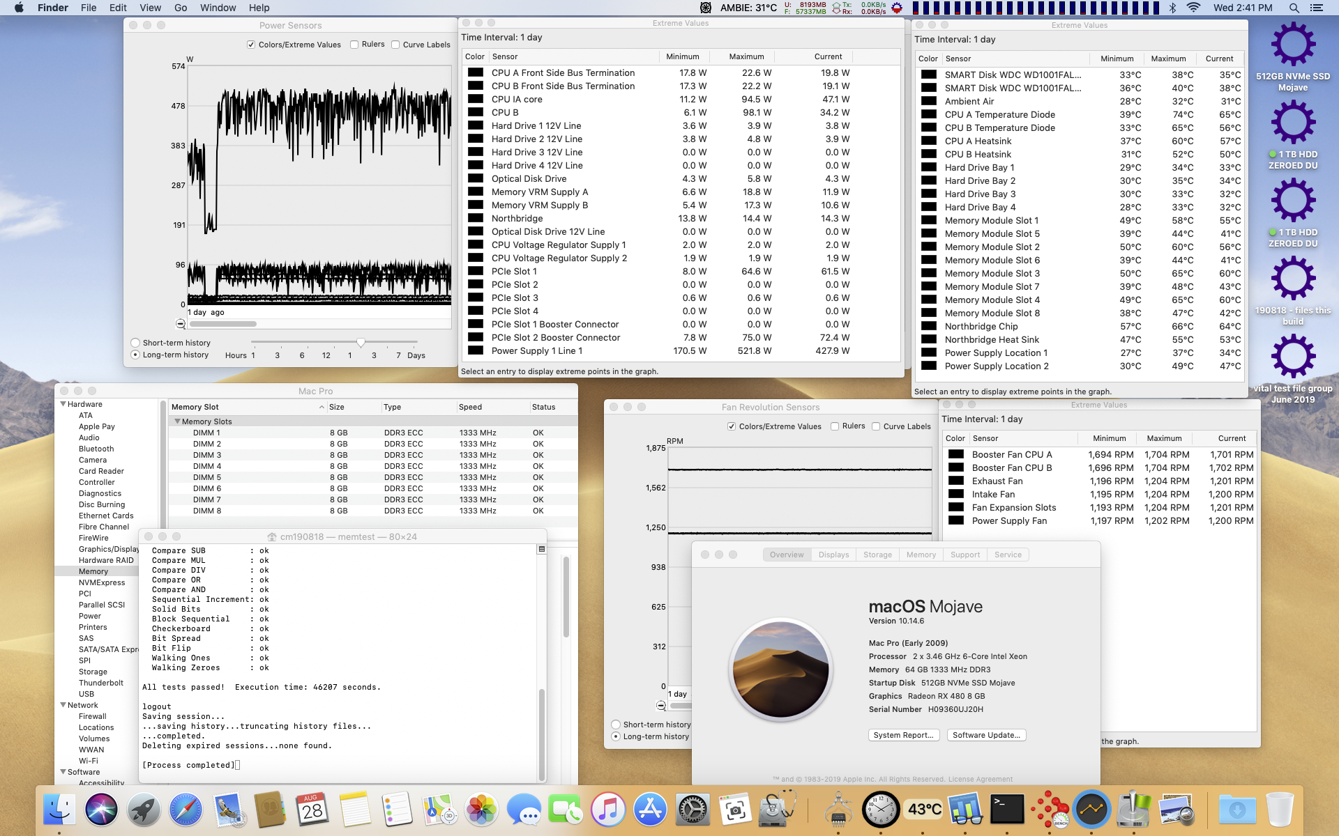

Here are some pictures of the sensor read outs during a System stress test with one of these RX 480s installed in a recent Build :
The PCIe air channel fan is set to a constant 1200 RPM because this is an AMD card and no unusually high temps were noticed with an infrared temperature gun in the PCIe slot areas . The blower fan on the card acts an an exhaust fan in this channel , since there is no system exhaust fan here installed at the factory . That actually helps to keep temps reduced in the PCIe slot area , over alternatives ( like open air type fans on GPUs , like found on the official RX 580 ) .

Seriously?
My problem with your post is that you don't warn people about it, since Dell cards use the reference design. Dell cards are made for Dell motherboards that can provide more than 75W.
Please don't generalise your own experience, use the search and learn about Dell RX 480/580 burning Mac Pro slots and shutting down PSUs when in full load.

What more can I say , Alex ?
Wouldn't the reference design be the one with ( AMD ) Radeon branding ? AMD designed the chip , after all .
I have successfully used Radeon , XFX and Sapphire branded RX 480 Cards in cMPs .
I have used a lot of Radeon and Sapphire branded versions of these cards in cMPs , rebuilt them with Arctic MX4 thermal paste , carefully set the system fan rotationals with Macs Fan Control because my average build is very high performance , place the System at load ( this usually involves the processor , memory , graphics card and drive subsystems placed concurrently at 100 percent load ) for between 12 and 24 continuous hours , observe all the thermal , fans and power sensor data for any abnormalities during the load test and then meticulously re-certify the individual components once the stress test has been completed . Because stress tests are designed to be ... well ... stressful . And the whole point of doing this is to test the rebuilt System under conditions more demanding than the client will experience with his daily workflow . That's for durability and reliability purposes .
Someday , over a few good beers , I'll tell you what a shake , rattle and roll test is . Because some of my rigs wind up in mobile environments and it's not a pretty sight to verify a workstation at load for shock endurance . 🤣
At any rate no RX 480 has shut down any System I installed it in . I must have the luck of the Irish 🍀 .
