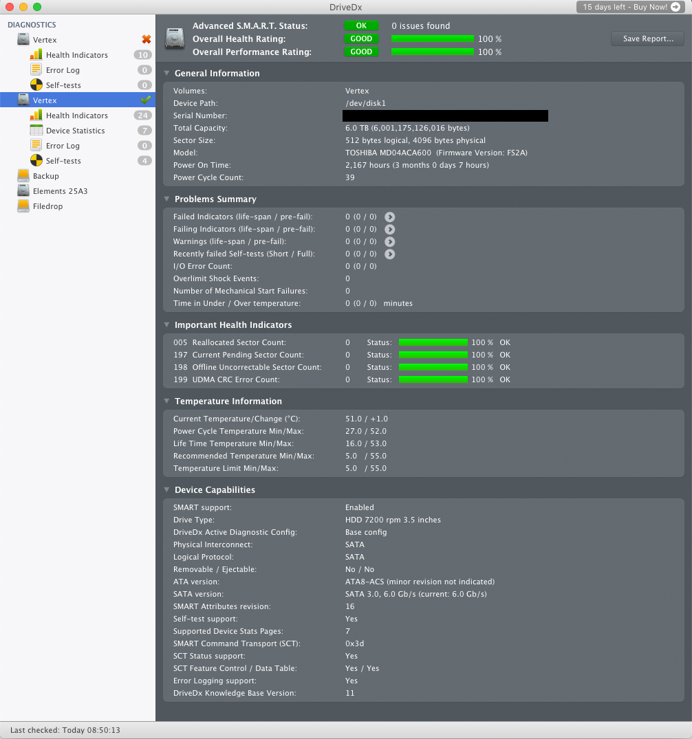

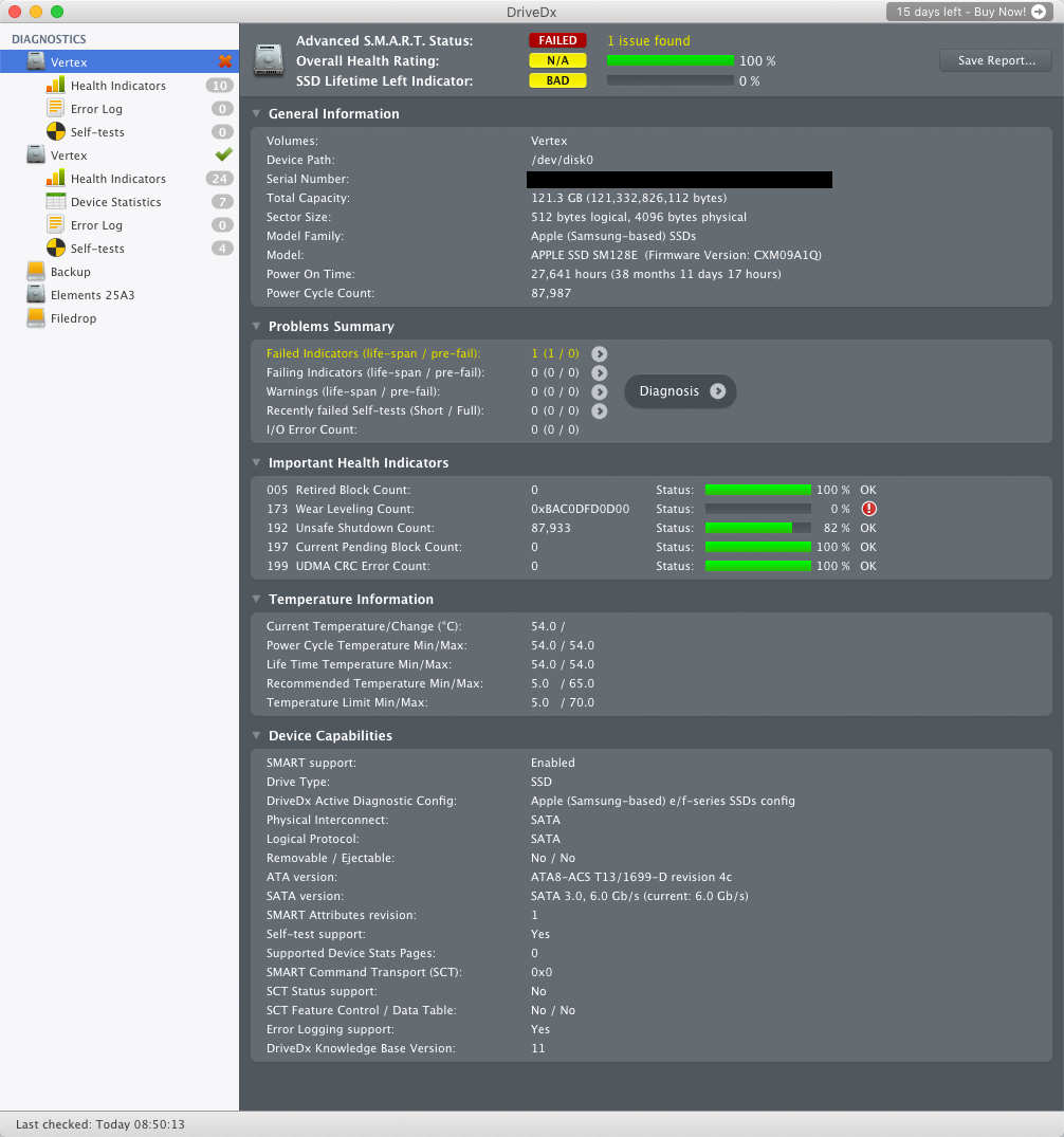

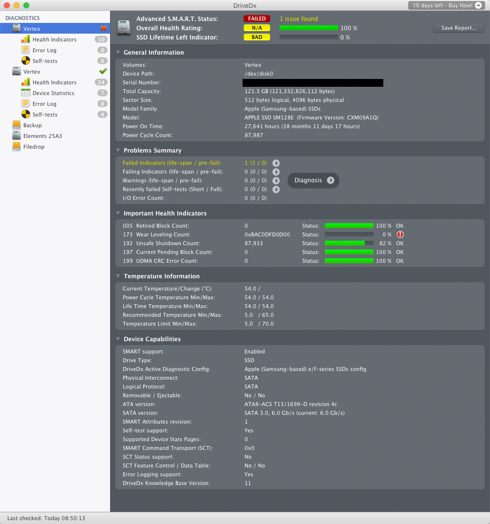

Could you install a system on the SSD part, then install DriveDx (has a free 15 days trial period) and post a screenshot of the SMART data from the HDD?

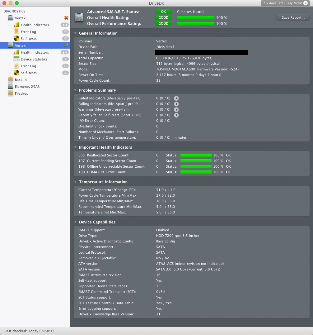

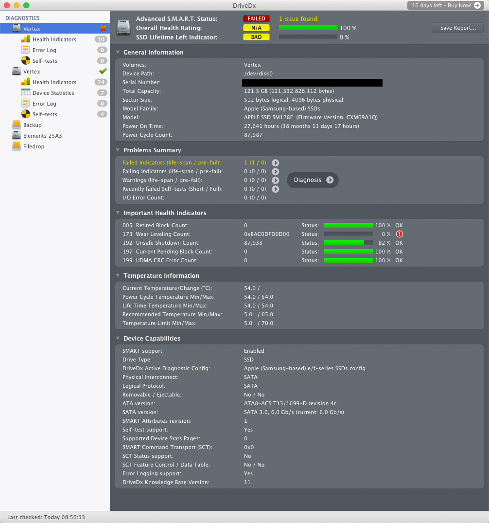

So it seems the Apple SSD is failing, while the 6tb replacement drive is fine.

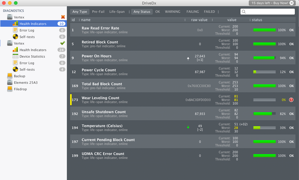

Exactly. The Apple SSD is dead. First time I see such an SSD worn out.
Could you post a screenshot of the health indicators as well? Curious to see how many terabytes you have written on it.
