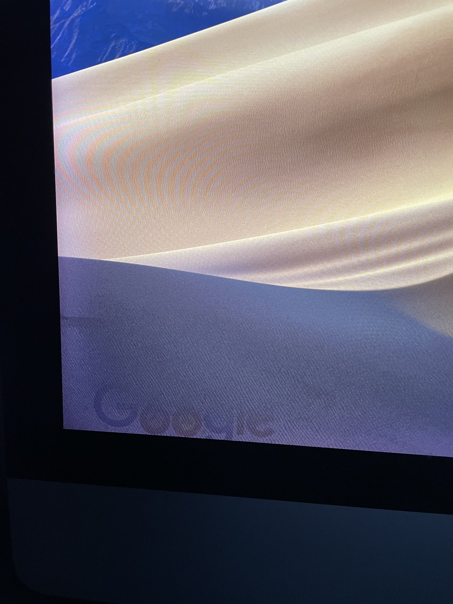

To date, I’ve been very impressed with the durability of my late 2015 iMac, but signs of its demise are finally starting to surface.
About 1.5 years ago, burn-in started as shown in the attached screenshot. It only happens from the edges going about 1 inch in, but then all is fine. When I move/close the window, normal colors return within 5 minutes. it’s absolutely bearable, as it is not getting progressively worse, but we all know it’s on borrowed time. How much longer do you think I have, will it break entirely, and is it okay to continue ignoring until it breaks? How much might a repair be?

The screen issue isn't going to deteriorate much, if at all, before the M2x Studio/27"iMac arrive so pretty much a non-issue.
I'd just ignore the ghosting and be fine with it. It won't be long before the M2x Studio is available

I recently sold my 2014 and it had burn-in but not as bad as what you have. I think that the 2015s are a bit worse than the 2014. I would actually only notice it when moving things around as the screen was fairly static for me. The 2014, for me, was otherwise perfect. i7, SSD, 32 GB RAM, high-end video card.
The thing is that I got a Studio and used them together for a while but then determined that I didn't need the iMac anymore. Yes, the screen was nice but the Studio is far more efficient and powerful.
I would not repair a computer from 2015 at this point because the odds of something else breaking is elevated. I have some other old iMacs and would not spend a cent to repair them when I could get them used really cheap. There's a 2014 for sale in my area for $325. I'd guess that it would cost less to just get another iMac than it would be to replace the screen.

Yeah, the burn-in is my #1 reason to consider a Mac Studio over iMac (if Apple even releases another 27") as my next Mac.. sure, I can repair the display of an iMac, but I expect a standalone display to last longer than an all-in-one display.
I hope to be able to ride this through to next year. The ultimate scenario that I need to figure out is what do I do if it completely craps out in, say, March, when a Mac Studio update is in, say, October. Oh, well.. that's my problem to figure out.. thanks!

I had a 2014 iMac with similar issues.
Technically, it is not burn-in, it is image persistence (aka image retention). Burn-in is permanent, image persistence is temporary, and apparently is due to overdriving the sub-pixels. It is possible to reduce it. For example:
Other people have devised other methods or used other apps, with mixed results.
The 2015 iMac is also notorious for developing pink edges. https://forums.macrumors.com/threads/2015-27-imac-has-pink-edges-anyone-else.2178372/
Both will get worse with time. The image persistence eventually bugged me too much, so I traded for a 2020 iMac.
The only possible repair is a new screen. Generally not worth it for a 2014/2015 iMac, unless you are brave and DIY (~$500 eBay)

Agree with wilberforce your experiencing image retention, not permanent burn in.
Run a screensaver for 10-15 minutes and see if that clears up your image retention.
Either Flurry or Drift should do the trick.
