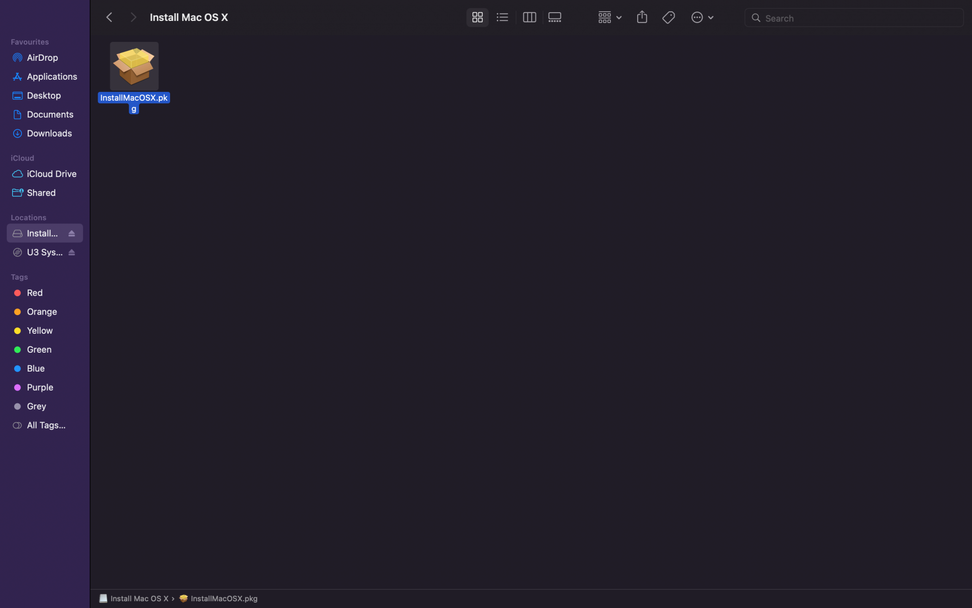

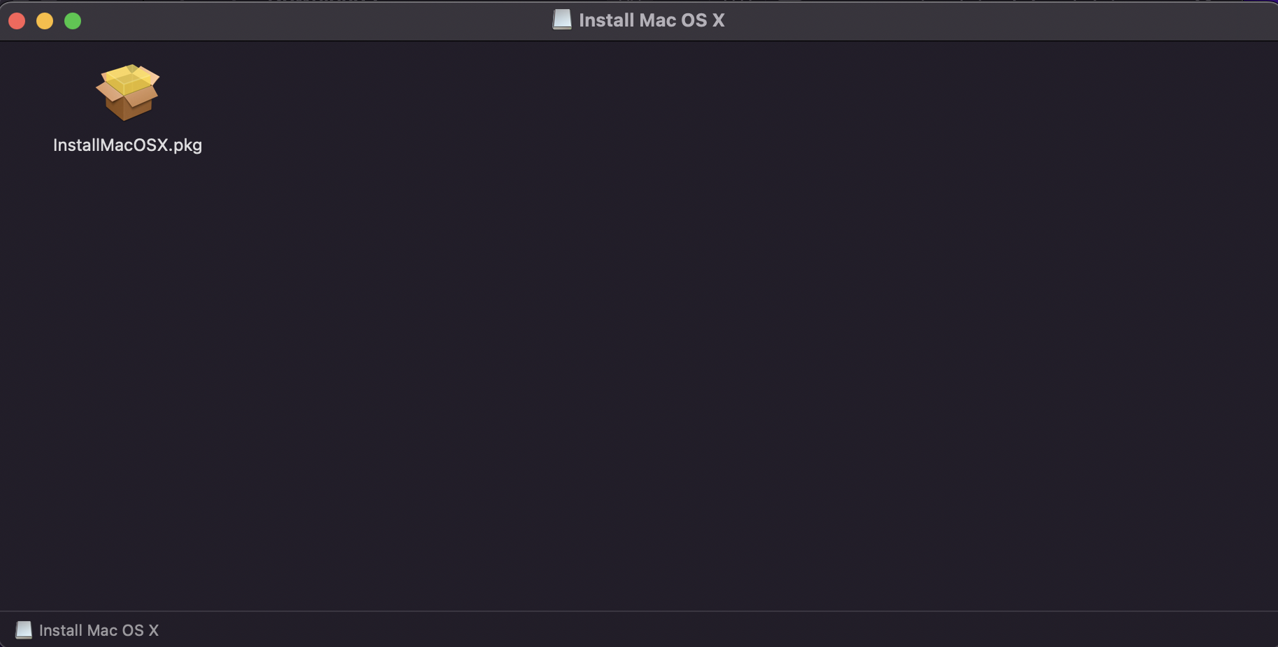

This is on the USB. I created it with the method provided in the video in my previous post. TransMac is a piece of software that extracts the dmg file to let Windows users make bootable usb’s.

Would could I do next. I'm new to this, it's my first time doing a clean install on a Mac OS X without already an OS installed on it.
This is on the USB.

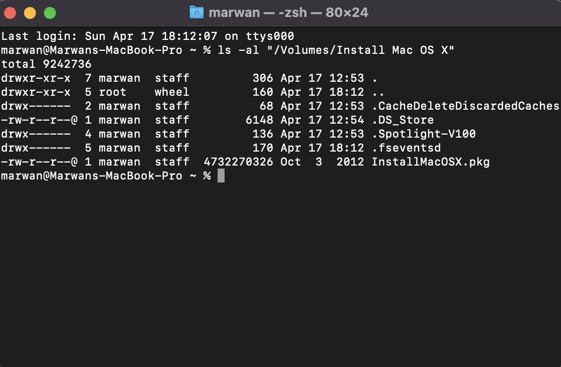

Please do the following: launch "Terminal" (it's to the left of Pacifist in your Dock) and enter
ls -al "/Volumes/Install Mac OS X"
Post the output of that command here. This helps checking if the Lion installer image has been successfully copied to the USB drive.
Thanks. This reveals that the USB drive only contains the InstallMacOSX.pkg package. That's not going to work.
Try the following:
  1. Open this package in Pacifist.
  2. Extract the following file (just this one!) from the package: Install Mac OS X Lion.app/Contents/SharedSupport/InstallESD.dmg. The file should be very large (4 GB or so).
  3. Reformat the USB drive (so that it's empty) and then use Carbon Copy Cloner or SuperDuper! on a Mac to properly restore that InstallESD.dmg file to the USB drive. Properly restoring means doing an exact block-by-block copy. If these tools don't accept the image file itself as a source, double-click it and use the "Mac OS X InstallESD" volume that shows up now as source.
  4. If this succeeds, you should now have a bootable Mac OS X Lion USB installer to use on the Mac Pro.

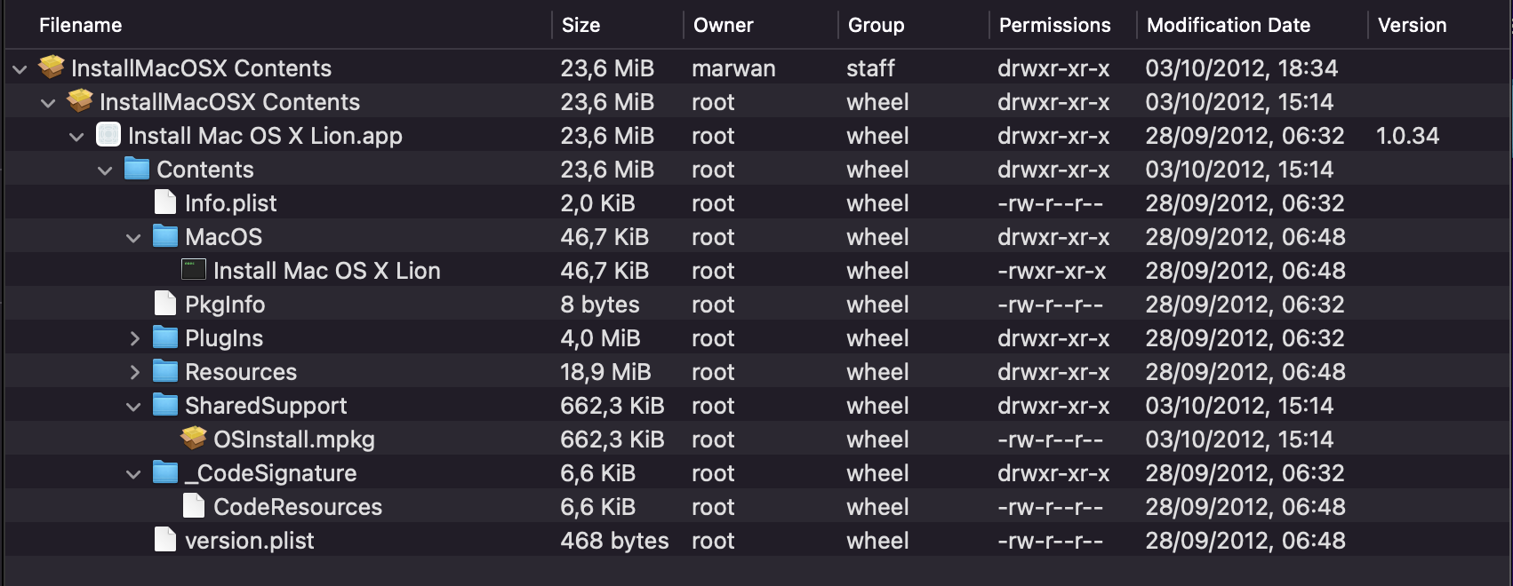

I can't extract it.
I can't find the .dmg file either. It has OSInstall.mpkg in that folder. It does not do anything when I extract that file.
What’s the size of the InstallMacOSX.pkg file in Finder? According to Terminal it’s about 4.7 GB (which sounds right) but Pacifist says it’s less than 240 MB. Something doesn’t add up.

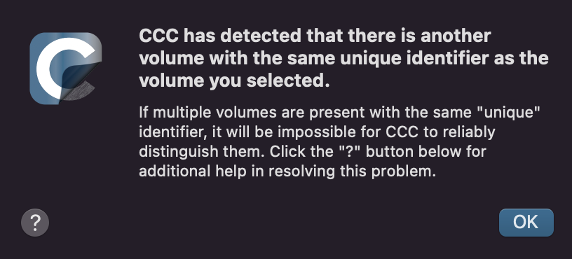

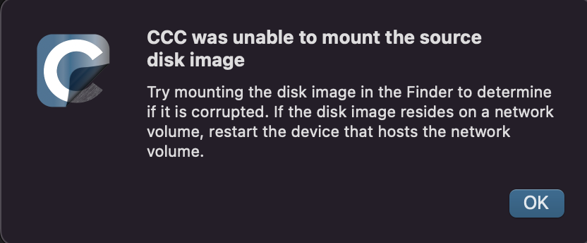

This is what I get when selecting the installesd.dmg file in Carbon Copy Cleaner.
This is what I get when using using the second method by double-clicking.

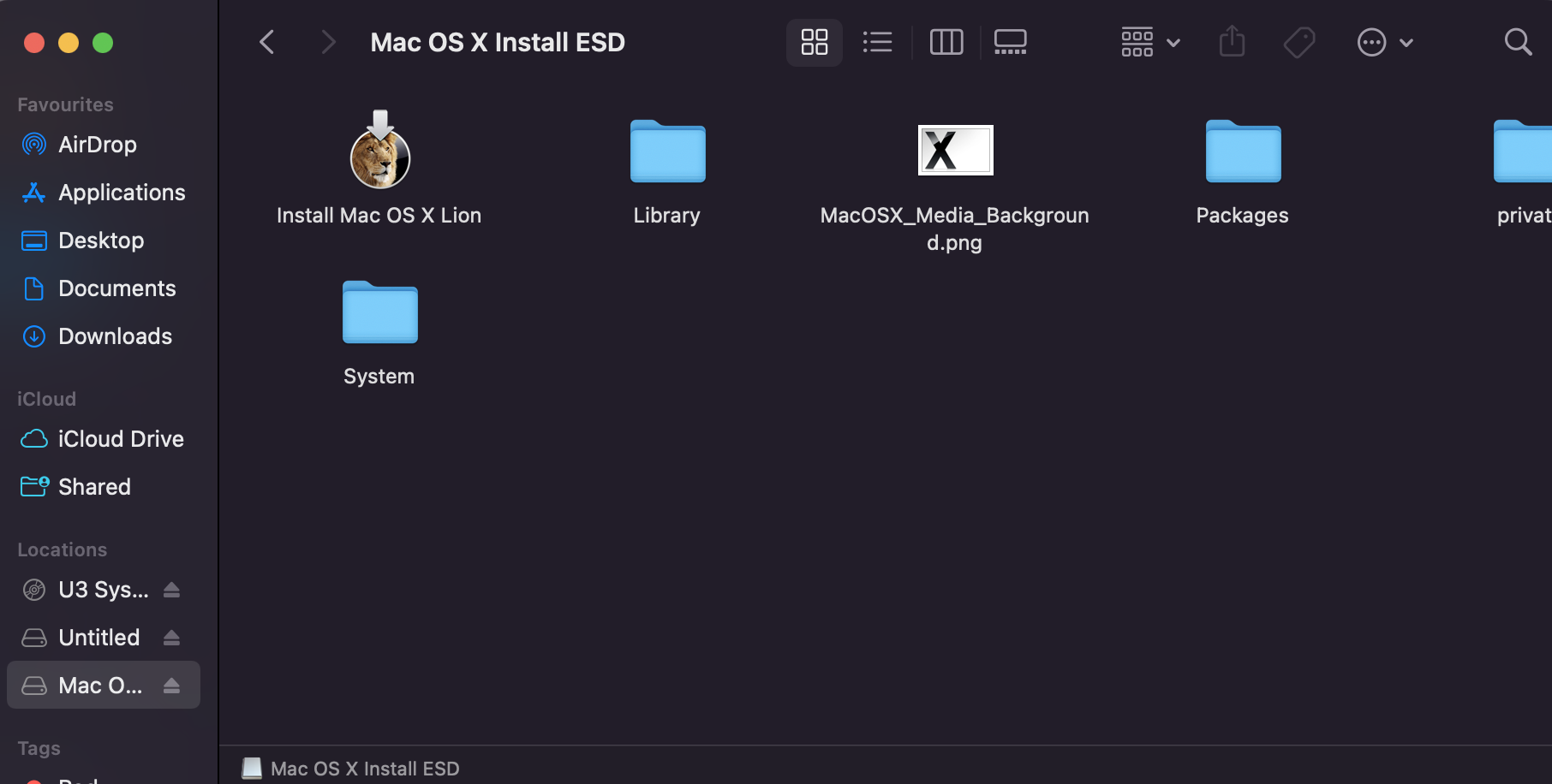

Sounds right. Can you mount the image in Finder?
I don't really know what you mean by mounting the image in Finder.
I can open it like in the picture above, but whenever I try CCC to select it as a source, it still gives me the error with the fact that there is another volume with the same unique identifier.
I can open it like in the picture above […]
That’s just what I meant by mounting. :)
Can you try restoring the “Mac OS X Install ESD” volume to the USB drive using SuperDuper!, in case CCC doesn’t like it for some reason?
