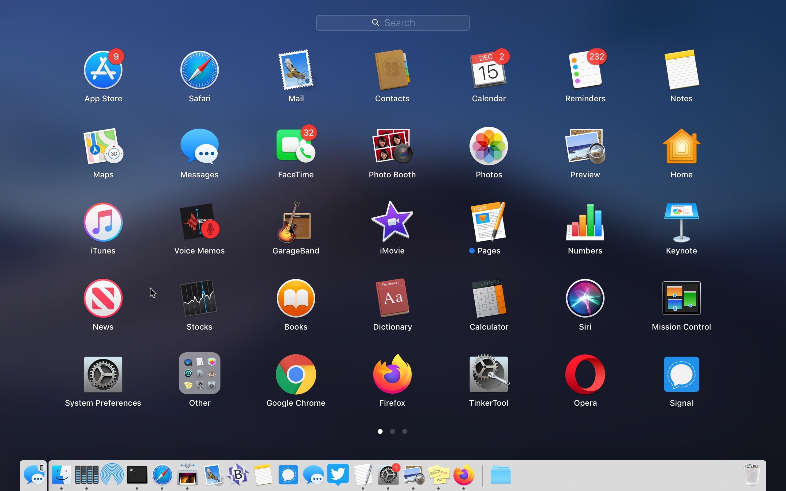

This is a known issue - there are posts on the Internet but no obvious solution. Launchpad just pops up on the screen at random. We have 3 Macs and they all do it - Mac Mini 2012, Mac Pro 2010 and just got a M1 running Ventura clean install but that does it too. All 3 computers use remote connection to the router. I have a 4th Mac in another room, 2010 Sierra, wired to the router, and that one is OK. This is an infuriating problem and makes using the computers a nightmare. We've tried swapping displays, keyboards and mice but the issue persists.
