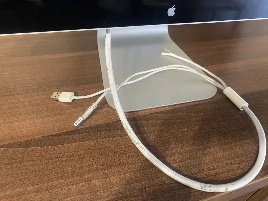

Somebody is offering an LED Cinema Display for cheap as the Thunderbolt connector is missing. Is this an easy repair and what do I need on components to do it? Is it as simple as cut the end of a Thunderbolt cable and solder it to this cable or does it imply some chip?
L.E.: Sorry, I mean a mini Displayport cable, this monitor is only the precursor of the Thunderbold one as I just realised my mistake.

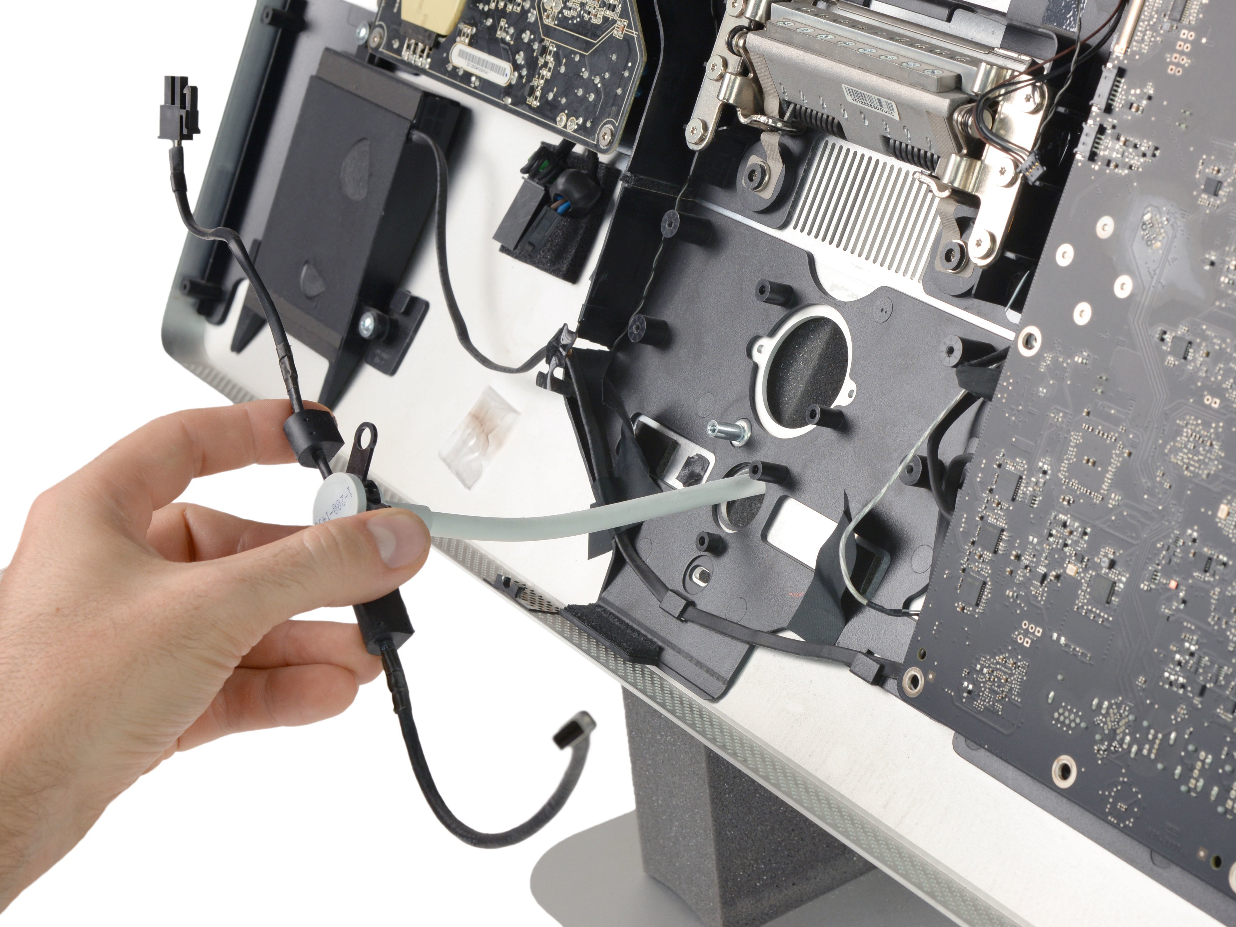

I found this great site called iFixit. They seem to have a lot of tips on how to fix various gadgets.
For example:
Fortunately, it has a standard thunderbolt connector internally. So worst case, you could open it up and replace it with a new cable. Then you'd have two cables coming out the back, but should work I think.

Ah you’re right. Sorry about that. Got confused by the cut off bits.
It is the A1267, EMC2263. Cinema Display LED from 2008 to 2010. 24".
He wants around 50 €.
My problem is that I would like a 27" better.
If simply soldering an end piece works, than I would do it. If I have to disassemble the entire monitor, I am not sure I want to invest the time.

The cables for the 24 are pretty scarce, there is a high probability the cable from the 27" monitor might just work as well.

You can try rewiring it to a normal size DisplayPort cable to see if it works, provided that you got it for free.
