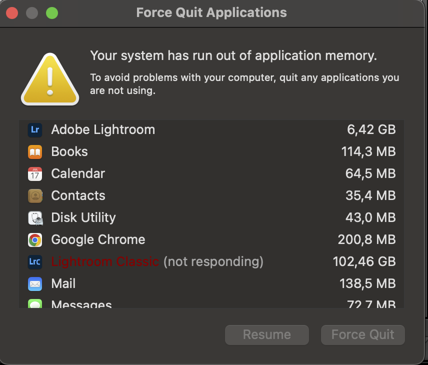

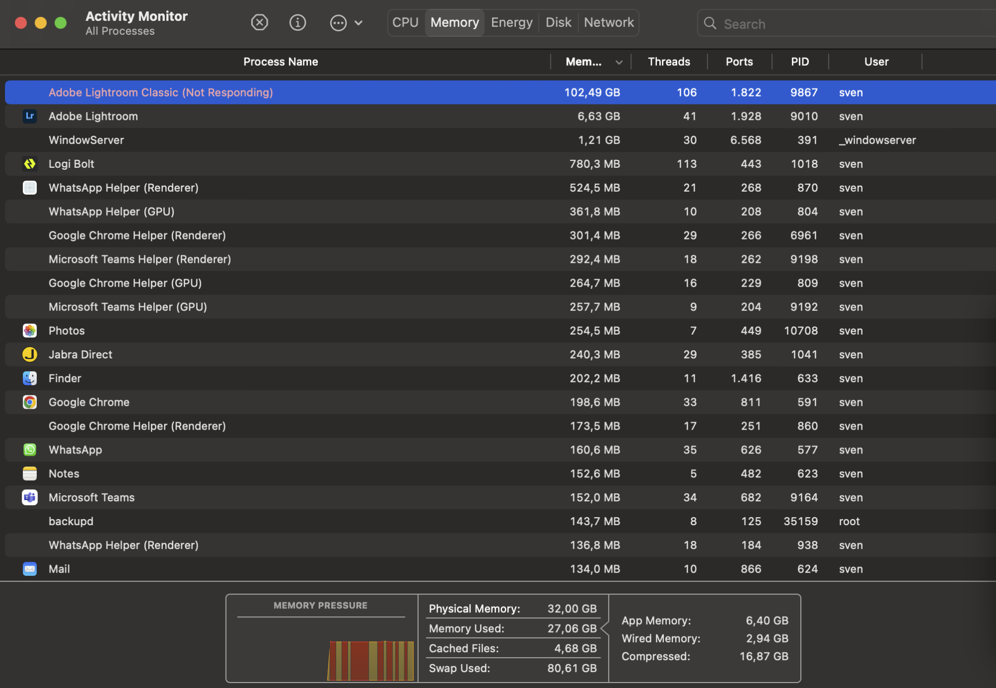

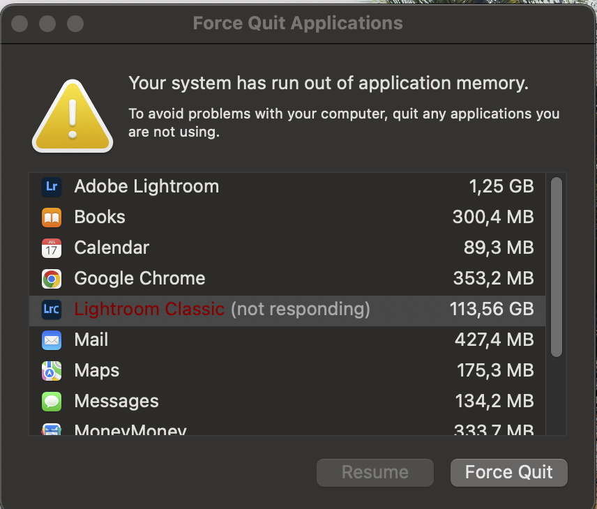

Since macOS Ventura 13.1 I am seeing enormous memory consumption using Adobe Lightroom Classic 12.1 release. If I keep the app open for a few hours my RAM and swap is getting filled up until Lightroom Classic crashes (see attached screenshots of memory usage).
Does anybody of you have similar issues? I have googled for the problem but didn't find any related posts about that.
Thanks!

Yes, I had this too. I my case, it was a permission error. When installing it my network security software (little snitch) stopped it from installing some files and that did exactly this.
To fix mine, I did an uninstall and re-install again and it fixed it.
Reactions: Jumpthesnark
Oh, I have LittleSnitch running. Ok, I will reinstall Lightroom Classic with LittleSnitch stopped. Thanks for the tipp.
Hope it works but yeah the install connects to the Adobe server for something and I missed Little snitch blocking it. I was pulling my hair out for days then found an obscure message in the log files that adobes fix for was to reinstall.
I have pi-hole running as well, I haven't seen any queries blocked on that side. I keep an eye open and Lightroom running over the night. Do you know where I can find the logs? /var/log(s) has nothing on that matter.
Just in the console messages and I turned on Lightroom install logging in preferences

So, uninstalling Lightroom Classic and re-installing it without LittleSnitch enabled, memory leak does not go away. So, I am stuck with the support of Adobe.
Any other ideas to get this issue fixed?

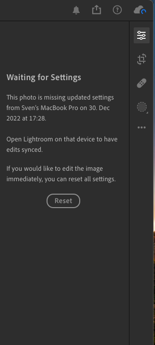

The issue remains whether only one or both apps are fired up. Actually, both apps are open because for the same time (since the latest major releases of Adobe), syncing does not work properly. I can wait for hours and nothing happens. Lightroom Classic tells me that everything is synced whereas Lightroom does not believe that.
Go into preferences, go to the sync tab, hold down option and click the rebuild sync button that appears. Then restart Lightroom. Click to unpause sync and it should start again.
Thanks, didn't know that. I tried that and took nearly 12 hours to complete but it didn't solve the problem. Now I have even more images stuck with that message. Guess I wait for the next minor release update.
Wow I am being zero help sorry. These are things I have done to resolve the memory leak and sync issues.
I did some more (probably useless) reading around it. Now I have managed to make your issue worse. I feel obliged to keep trying.
Some people have reported that going to the desktop LRC and creating a virtual copy, then going to the original and resetting the edits, then copying the edit settings from the virtual copy back to the original seems to fix it sometimes. Others suggest a minor tweak of a setting will trigger a refresh of the settings sync.
Apparently this is a known issue dating back to 2018 and Adobe are yet to fix it. The good news is that it seems to be that the image itself is safe, just that the edit settings for some reason have not been synced properly.
Also, for a debug log for LRC, go to preferences, account and hold option and the log button should appear.
