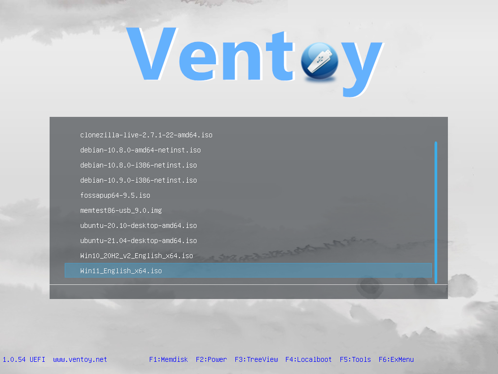

Multiboot can be a bit technical for most people, proceed with patience. Or explore Ventoy (this is what I use on my iMac), my wife uses Windows on her MBP. Back to Ventoy, you can boot multiple operative systems (isos), or if you have patience to create VHD files (virtual machine hard drives), then it's an option too, that's what I use.

For testing distros I usually go with ventoy to be able to have multiple live isos on one USB or harddrive, but lately, I go for debian with Xfce or other wm, canonical it's doing weird things that I don't like , like force to use snaps with Firefox (I know that you can get through package) and it doesn't feel fast, I like Linux mint for the facility to use but I feel every Ubuntu release that I don't are their target anymore so I'm now enjoying debian 12 in almost every computer that I own and probably never go back to Ubuntu or it's downstream distros

Given the ubiquity of USB thumbdrives these days, I'd suggest just grabbing a few different distros (Ubuntu, AntiX, Mint, Manjaro, Debian, etc), putting them on a thumbdrive, and testing them out via live USB booting. You can use Rufus or similar tool in Windows to create the live USB thumbdrives from the Linux ISO of your choice. This way, you can get a very good sense (without installing anything on the internal disk) of what works and what doesn't before you choose to install to disk.
Here's what to do with ISOs:
