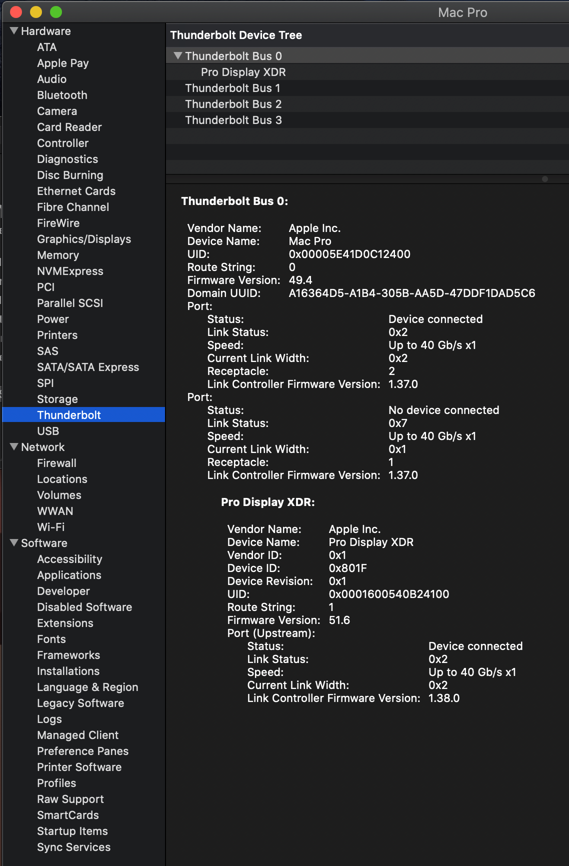

Can you post a screenshot of System Information > Thunderbolt? Is the connection recognized as 40Gbps?

AMD Radeon Pro Vega II 32GB graphics. Only the Apple Pro Display XDR is connected. Have tried every TB3 port on the video card.

Check the Thunderbolt link width and link rate in System Information.app. It must say 40 Gb/s x1 with link width 0x2, otherwise you won't have enough bandwidth for 6K with the Vega II. If you had a 5700, then a 20 Gbps connection might be enough.
Here's the Thunderbolt link information...it's detecting the Pro Display XDR on Thunderbolt Bus 0 and has the speed at 40Gb/s x1 with 0x2 current link width.
No other devices or displays connected to any other Thunderbolt 3 ports.
It seems to be properly connected as a Thunderbolt 40 Gbps device. Check USB for the USB controller of the Titan Ridge controller of the display. If it were connected only as a USB-C display then there wouldn't be another USB controller (and it wouldn't be listed in Thunderbolt devices). The USB controller of the XDR should appear in PCI as connected to a Thunderbolt PCI bus.
I guess next thing to check is output from AGDCDiagnose. With a 40 Gbps Thunderbolt 3 connection to a Vega II, it should show two HBR3 connections.
You have no problem with the cable that came with the display? You may need to report to Apple that their driver is not allowing a 6K connection with this cable (do you have another Thunderbolt device that you can benchmark at over 2000 MB/s such as an eGPU or NVMe drive to prove that the cable is capable of 40 Gbps?
