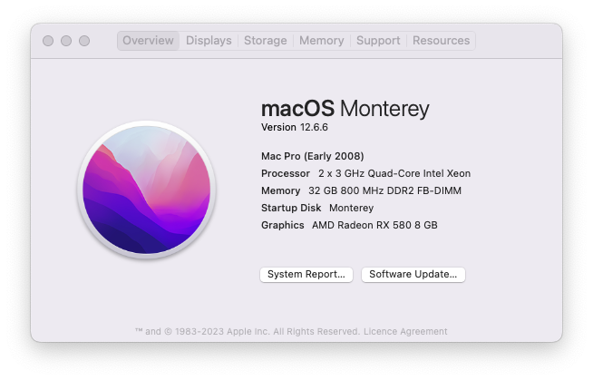

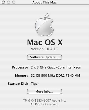

I'm currently on a cMP 3,1 which I've had since new (see sig). It's currently running DD1 High Sierra which is getting long in the tooth so I'd like to be able to use a more modern OS. For that I'm considering OCLP but that seems more tricky on 3,1s than on 5,1s, hence my thoughts on buying one of them.
I've upgraded my machine several times over the years, with HDDs and SSDs, a Sonnet Tempo and various video cards. I was considering the Mini but I'm fond of the modular design of the MP. I've always enjoyed the flexibility that offers and like to have the PCI slots for further upgrade possibilities. I also use certain older software for my film scanners, which doesn't run on newer machines. The typical image files I edit are perhaps 500MB and my 3,1 handles them well, even when stored on SATA 600 HDDs so I don't think I need a super fast machine.
It's perhaps a bit stupidly nostalgic, but I also like the idea of keeping old machines running. I'm typing this on a 2015 11" MBA which is natively running Monterey and find that pretty cool (I'm a bit silly like that, but then again I only use film when I photograph...).
Strange thing is that apart from the MP51 possibly being a tad faster, there is nothing you seem to want to do that can't be done with your existing MP31 and in your shoes, I will stick with the old girl; which happily runs everything from Tiger to Ventura.
I don't use the OCLP, so I am limited to merely everything from this:
... to this:
RX580 works nicely from Tiger to Mountain Lion even though not accelerated (minor glitches as from Lion). The glitches really become apparent from Mavericks and stay until proper support appears in Sierra. From about Lion, Apple apparently started bloating the OS and tasking the GPU just to run the OS.
Anyway, I fully understand the power of upgrade fever once it sets in (even for another vintage unit) and using the MP51 can definitely be a lot easier as there are simply a lot more users hacking it around. I am thinking upgrade fever has taken hold as you appear to have concluded it would be too tricky to run newer OS on your MP31 without actually trying to ... classic symptom. Nothing wrong with this btw!
My overclocked Mac Pro 3.1 (overclocked by boot script 3.16->3.79Ghz via FSB with DDR2 400 32Gb) -
... has the same Geekbench score as a single processor Mac Pro 5.1
One might overclock even faster and get a Mac Pro 3.1 which is even faster than a standard Mac Pro 5.1
