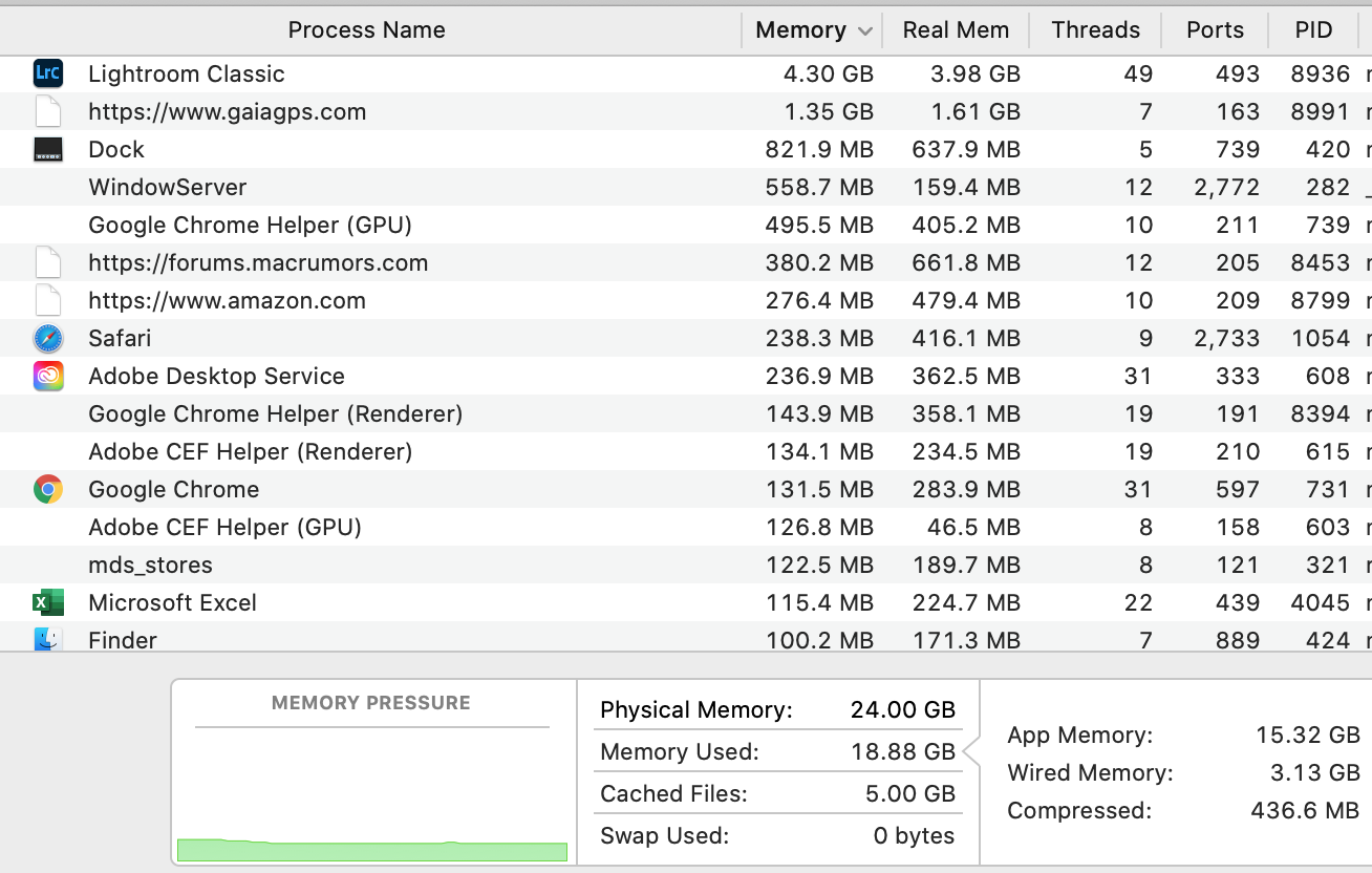

I have the exact same iMac as you, and added 2x8GB sticks for a total of 24GB. Runs great, and a huge improvement from 8GB. For photo-editing it occasionally uses all 24GB. Go for it. My sticks are Crucial, but I don't see why PNY wouldn't be fine provided it is the exact same spec
Here is my typical memory usage, having 24GB. You can see that 16GB would mean I would have to use swap memory. YMMV, obviously
Not as obvious as you might think.
If you have more memory, your Mac uses more.
Conversely, if you have less memory, your Mac uses less.
Swapping may come into play, but not necessarily.
