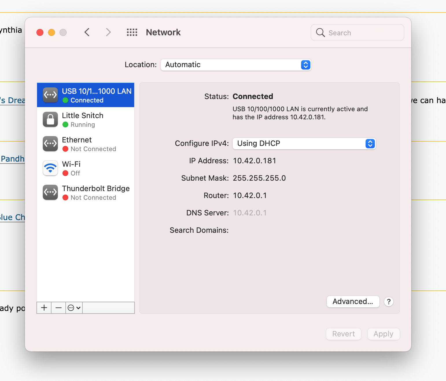

I have this dock I use with a M1 mini and the Ethernet port works OOB.

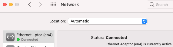

Q:
My M1 Mini Ethernet is connected thru the back of my 27" Thunderbolt display - I noticed it does not say "Display Ethernet" like it used on my old Mini, instead it says "Ethernet Adaptor (en4)"
Anyone know why??
