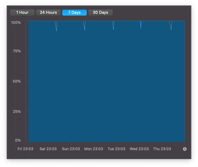

Identical behavior on mine (16 inch MBP). Discharges to 90% and then charges back to 100% immediately. Happens every 28-30 hours or so.

I'm not disconnecting mine at all, and it's still doing this daily. I kept thinking it'll eventually just settle down to 80% and hold there, but it's been over a month. Always plugged in, and yet every day it discharges to ~90% and then immediately charges back to 100%.
I spoke with a senior advisor, who agrees that this sounds like neither Optimized Charging (which predicts when you need 100% charge and wait for optimal time to charge back up) nor Battery Health Management (which may reduce total charge level to say 80% to extend battery longevity). Even tried escalating this to engineering. They came back and told me to do a clean install, which I did. This discharging happened WHILST the system was being re-installed, so it feels like this is something baked deeply into the firmware...
Things I've tried so far –
1) Disabling Optimized Charging;
2) Deleting content in /private/var/db/powerlog, /private/var/db/powerUI, which cleared out the battery histories, hoping a retraining of whatever model smart charging uses would occur;
3) Reinstalling the OS;
4) Using a different set of power adapter + magsafe cables.
5) Forced a few full discharges.
None of these worked.
BTW I think this only started happening after I re-installed the OS after 12.1 came out. Before 12.1, the system did hold the charge level at 80% after a while. So it's possible it's a new, undocumented behavior. Or it's a bug...
