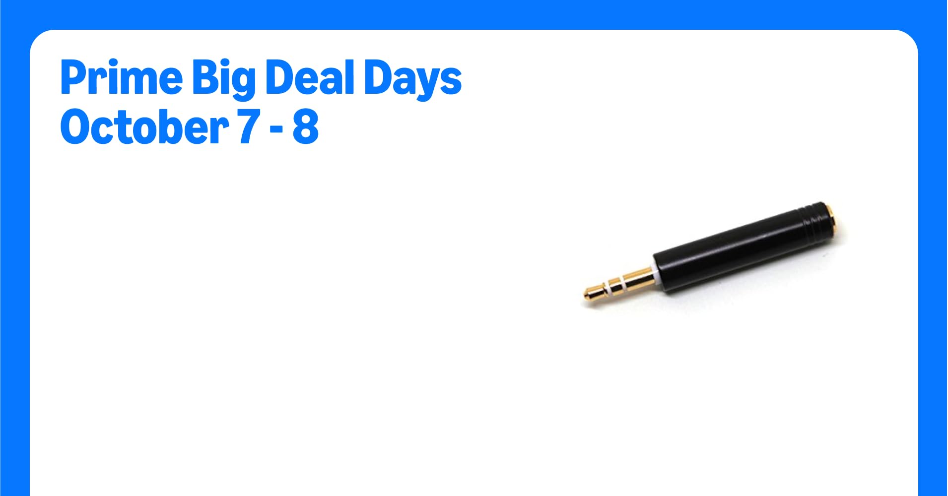

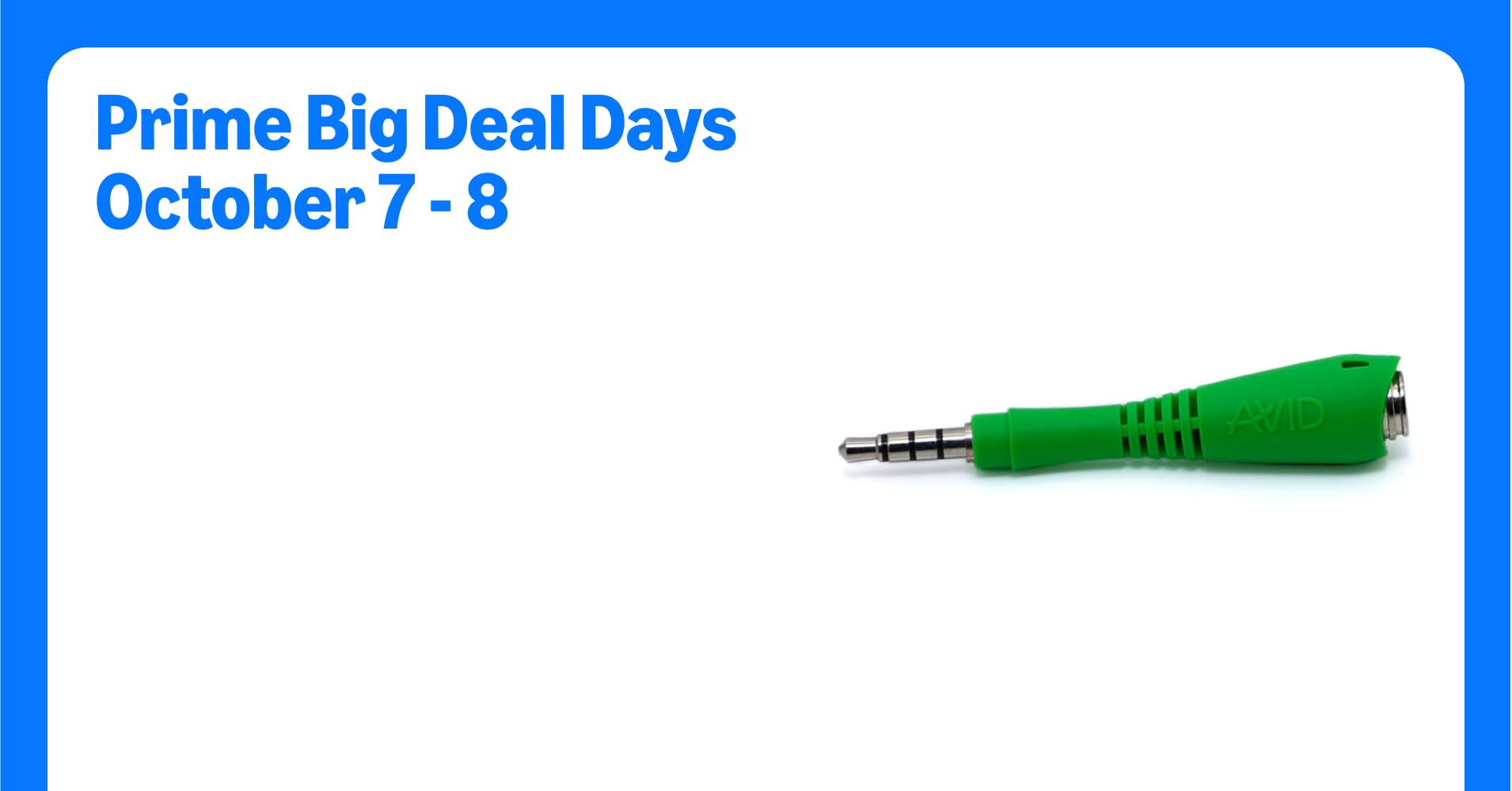

I ended up buying an 80 Ohm impedance adapter. It eliminates the CPU noise and the popping noise when the audio circuit turns on. I don't understand why Apple didn't consider low impedance headphones in their design.
80 Ohm Impedance adapter:
Might also want to get a strain relief:

Using a 220 ohm impedance plug, solved the problem for me (80 ohm was close but not good enough):
https://www.amazon.com/FAAEAL-Conductor-Impedance-Cancelling-Professional/dp/B07FM8GJL4?th=1
Make sure you push your headphones into the impedance plug with a little force, so it clicks in. Some people can be fooled into think they've put their headphones into the impedance plug properly when they haven't. I would also recommend connecting the headphones and impedance plug together first, and then plugging the whole thing into the mac headphone jack.
