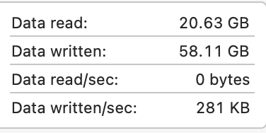

As you can see, I have 30TB of data written onto my SSD. I don't use this device for anything but web browsing and light programming. No professional production work or gaming. With my usage throughout the life of this device, I can confidently say that there is no way I would have done enough work to write up to 30TB of data.. so what the heck could it be?
I've had this device since Dec of 2021 only!
I currently have a device uptime of 13 hours and it's already written 58GB of data. What the heck is it writing? I'm only web browsing. According to the activity monitor, these processes seem to be the culprit. Why would corespotlightd and photolibraryd be writing so much information?
Any help is appreciated.
There are plenty of threads on this, but long story short... it's not a big deal. MacOS will use swap regardless of if it has memory available or not. You can disable it from using swap unless absolutely necessary, but the amount of swap you're seeing is entirely normal and you'll probably be dead by the time you wear out that SSD at your current pace.
I don’t think you understand what web browsing is. You are downloading the webpage just like you would download any file. It downloads the page and then shows it on the screen. It’s not all going to be in RAM.
Many people don’t understand that browsing the web means you’re downloading something. As the poster above me said, don’t worry about it because it will outlive its useful life.
