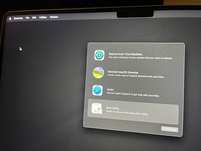

Sorry guys, more help needed please if you could...
I got pretty far into the Revive procedure, but then was presented with the option to Install Sonoma. I was told this was the way to go for a procedure like this, as opposed to Disk Utility which wouldn't work. Anyway, I get to the install Sonoma page and it asks me where to install, I click my HDD but (stupid me) it's pretty full and it says it can't install there and it needs another 8GB of free space. Any suggestions of what to do ?
Would installing on an external HDD work?

It's great that you got it booted (to Fallback Recovery?).
I think your focus at this point should be saving your data. Can you get a second Mac (even borrow one)? Try to use Target Disk Mode to make a backup of your data.
Thanks for the reply!
I used a second Mac with Apple Configurator to revive my bricked MBP by putting it in DFU mode, but it seems after it finished it booted into Recovery instead of booting into OS itself. Apparently reinstalling Sonoma should work and allow me to save my data. The problem is I'm 7GB short and can't install!
I have access to Terminal (it boots to -bash-3.2#), but I've no idea if I can delete files that way?
I also have access to Disk Utility, though I'm not sure if that will do much good?
