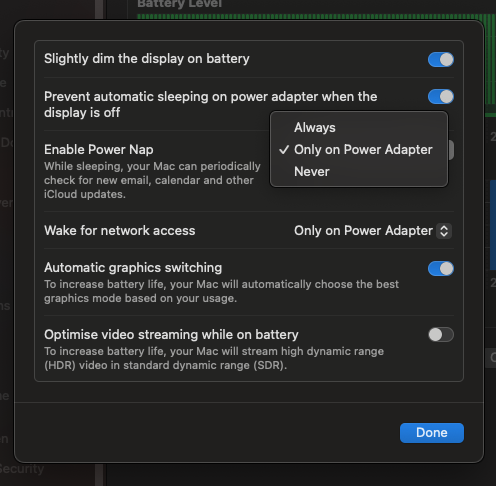

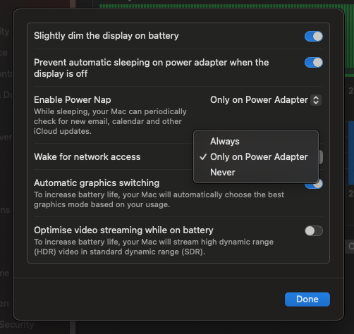

The logs have some "systemWokenByWiFi: System wake reason: <SMC.OutboxNotEmpty smc.70070000 wifibt bluetooth-pcie>, was not woken by WiFi" from previous days even though "Wake for network access" is set to "Never".

Never,

And Never.
