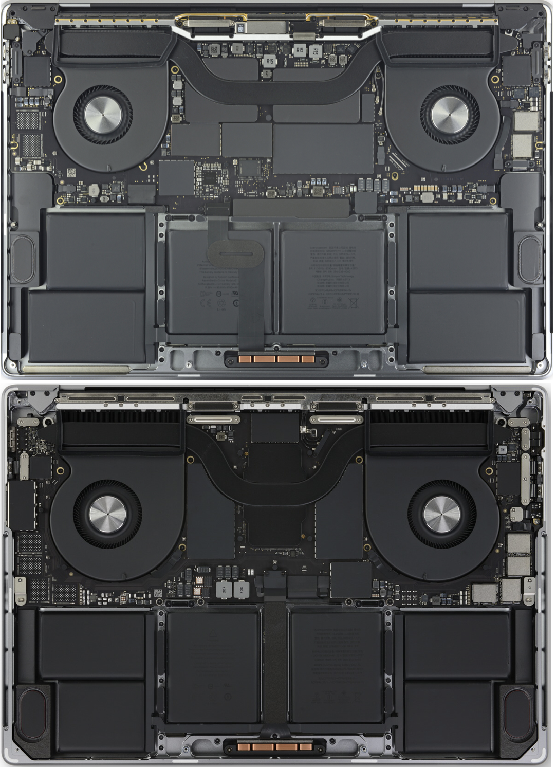

Intel 2019 MBP16 on top, Apple Silicon 2021 MBP16 on bottom.
It's a 0.4 lb difference and the 2021 model is 0.02" (0.5mm) thicker. Visually, it looks like the cooling system in the 2021 model is larger: bigger fans, bigger heat pipes, bigger heat sinks. If the heatsinks in the 2021 model are copper and the old one is aluminum, it will be doubly heavier.
What's more difficult to tell is that the 2021 model may have a thicker aluminum shell. The display/lid is stiffer than the old model, as I recall with the 2018 MBP15 model I had. So, some portion of the weight increase may be due to that.

Looks like changes were made for packaging within the chassis. Notice how the M3 model has things like speakers located in a different area then the Intel model and therefore battery locations are flipped on the edges. The Apple Silicon systemboard layout (along with it's extra peripherals) probably plays a role, as well. There is a wider gap between the forward battery packs that results in each being smaller than the packs on the Intel model.
Interesting, thanks for the images.
