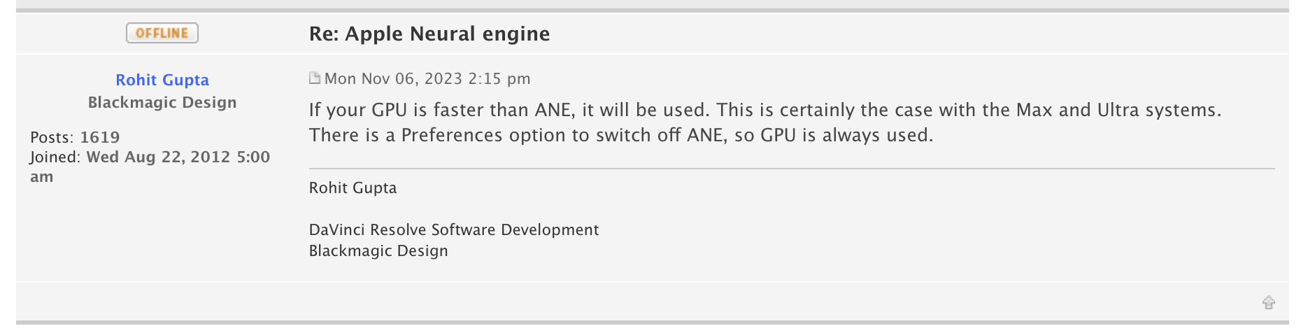

You might want to check out this thread ( https://forum.blackmagicdesign.com/viewtopic.php?f=21&t=158630 ). According to Rohit Gupta of Blackmagic, "If your GPU is faster than ANE, it will be used. This is certainly the case with the Max and Ultra systems. There is a Preferences option to switch off ANE, so GPU is always used."
I think it would be interesting to try your comparison again while playing with these settings. That might give you a better idea of what is going on.
