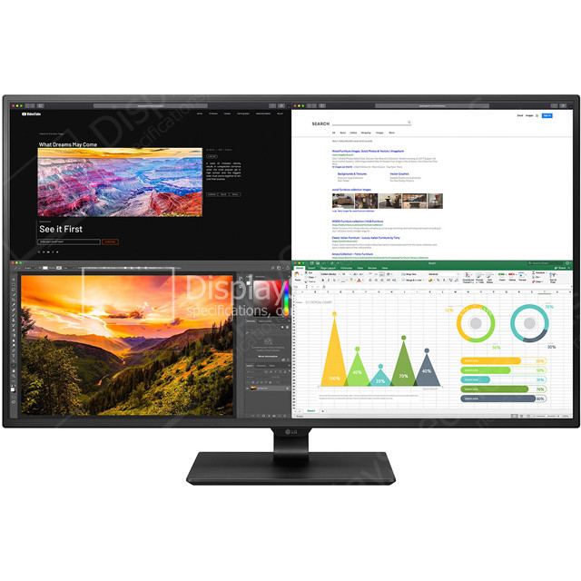

What monitors did you have? Monitor, native resolution and then all connectors of every single monitor, please
sorry, i´m late:
LG 43BN70U-B, __43", 4K / 60HZ​
i run it at 1920x1080 / 60HZ. // connected now: USB-C intio M4studio / i´d prefer HDMI ! (i have coil whine now)
2x HDMI 2.0
2x HDMI 1.4
1x display port 1.2
1x USB-C
this one is NOT running with 60HZ on my M4Mac studio => over HDMI ( i´ve NOT tested different ports ! i just saw the data the first time now myself / ie, two different HDMI types)
It is running now with 60HZ => over USB-C.
But: i have coil whine now (on the back of the display / ´ß annoying !)
__This display did run with 60HZ over HDMI on my M2mini-pro. ( same port / port 1)
my HDMI cable was working fine on my M4mini-nonPro and on my M2mini
