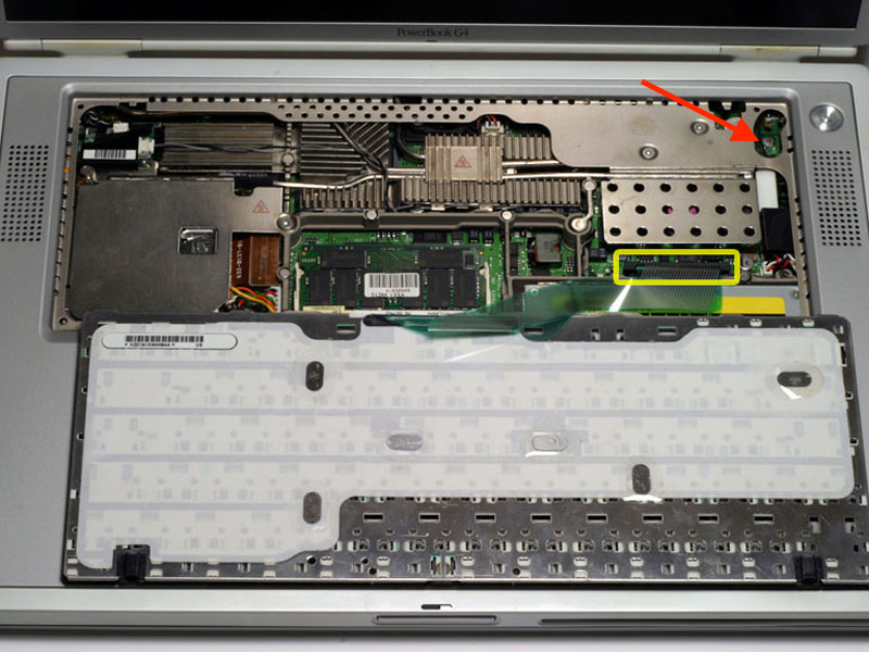

Another thing that might help, that I haven't seen suggested yet, is to press the PowerBook's reset button. It's on the upper right corner of your Titanium's logic board (I drew a red arrow on the below pic from iFixit, to show you where it is). With the AC power connected, but with the PowerBook turned off, press that button one time for about one second. Then boot up the PowerBook and see if that helps.
