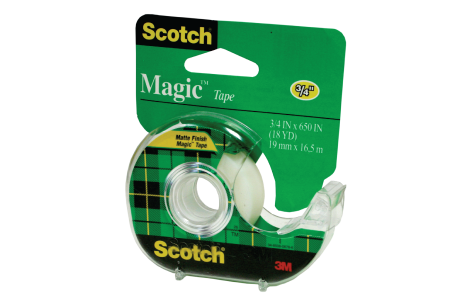

There is a known problem with these having an "overactive" power button, which as you probably know is capacitive. I seem to recall the fix being an application of a piece of scotch tape directly over the top of the button(on the "core", not on top of the case). You might give that a try.

Thanks for the swift reply, Do you mean (grey) duct tape or transparent packaging tape?
He means Scotch tape - or any generic equivalent.
