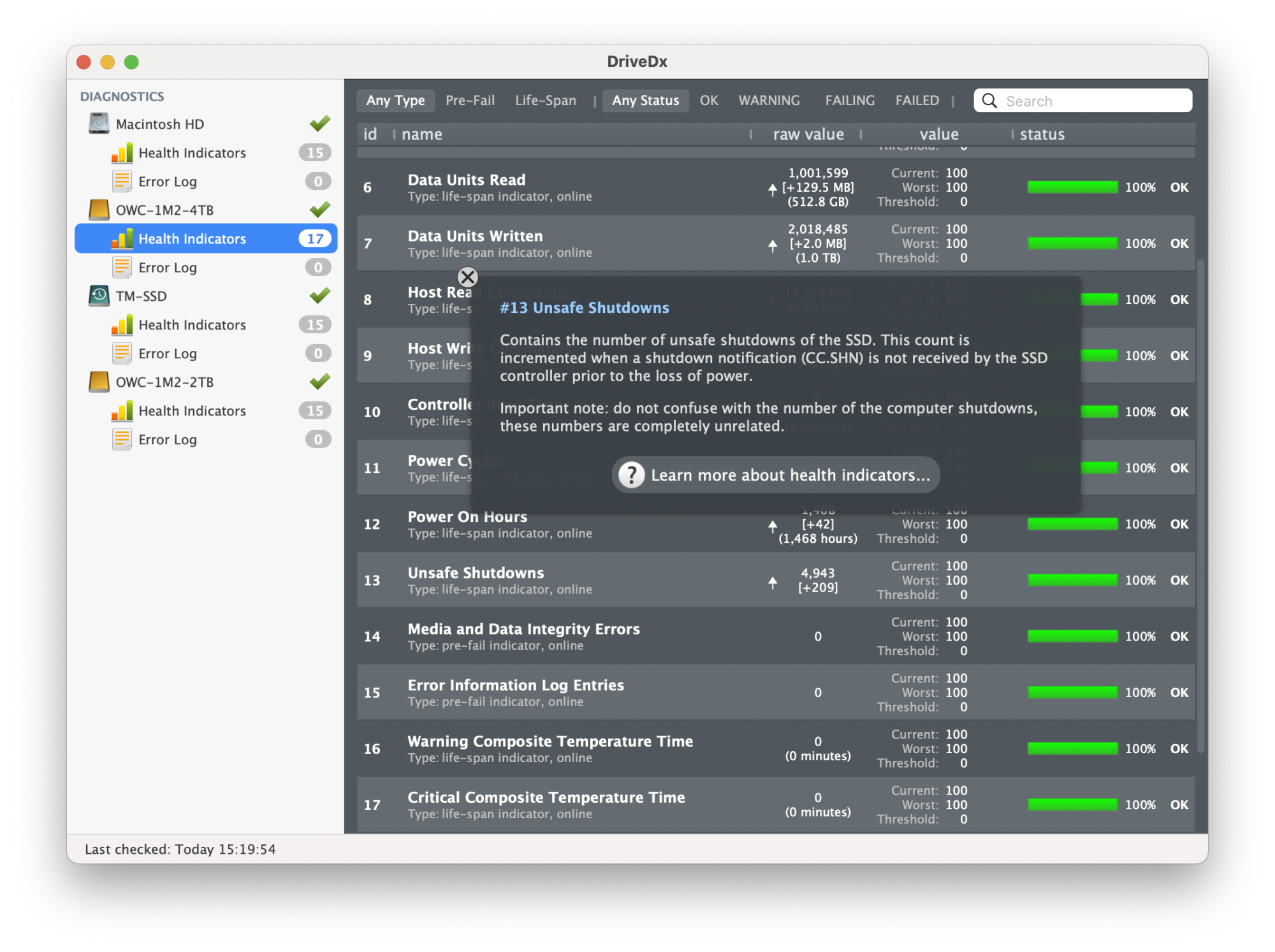

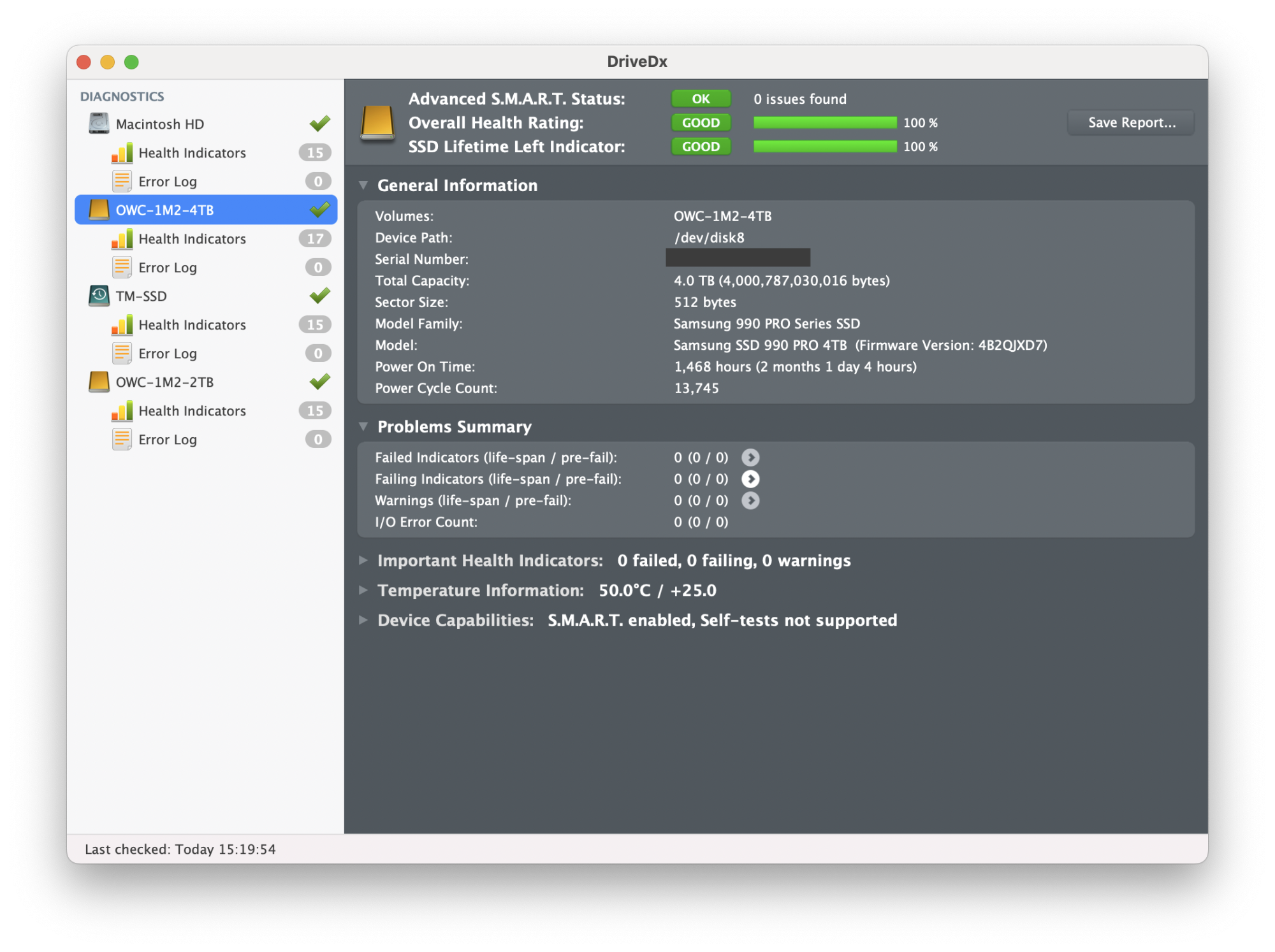

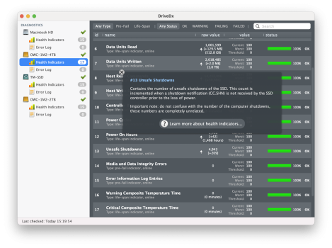

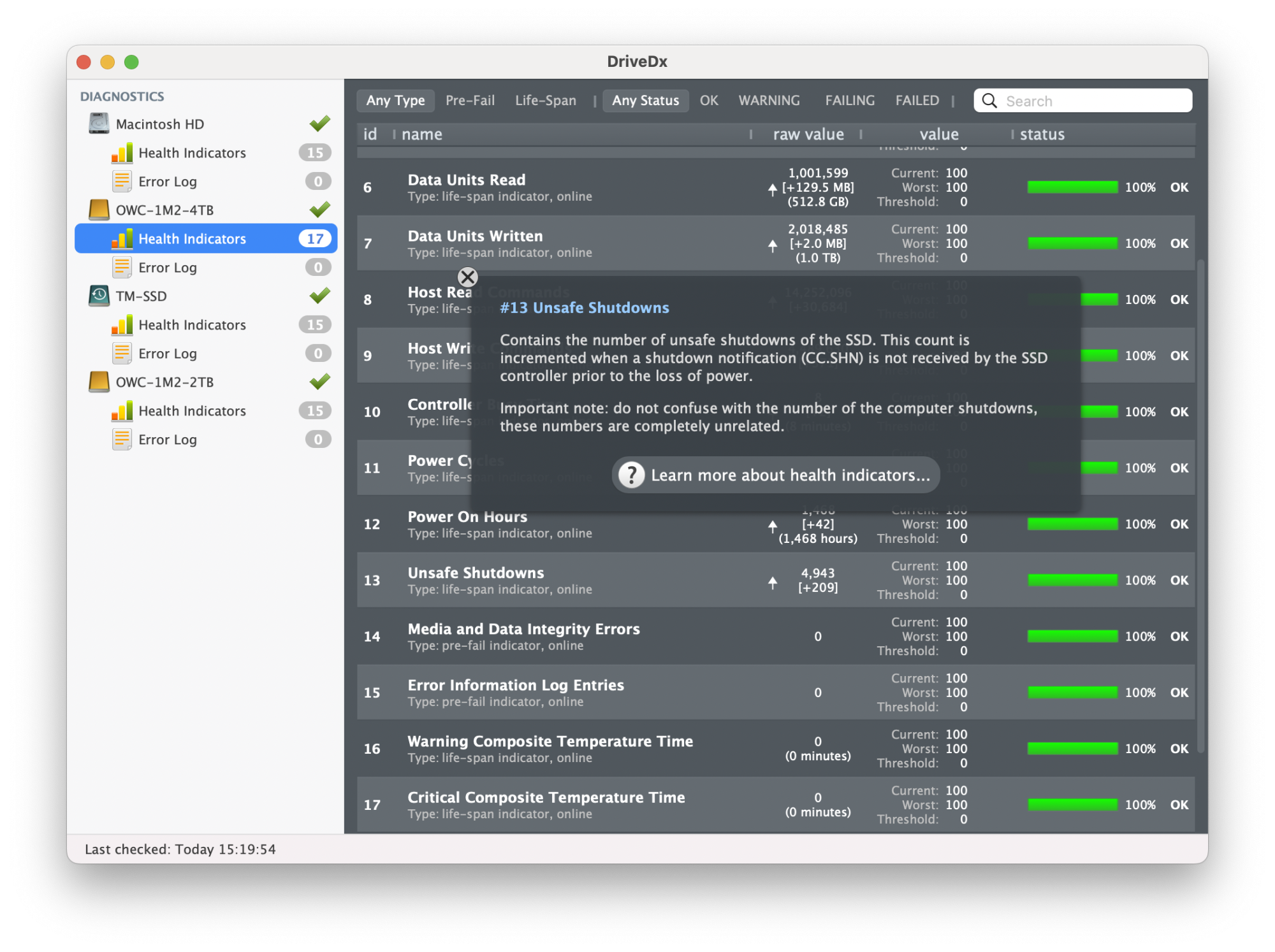

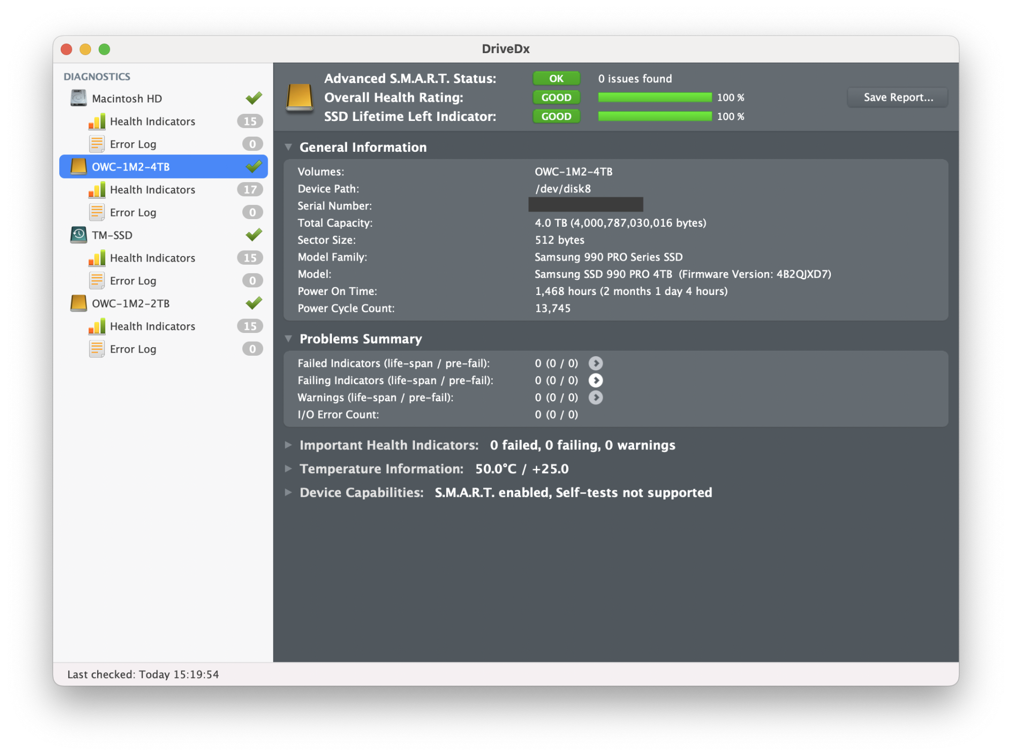

Samsung-990-Pro_OWC-1M2_081220251545.pngSamsung-990-Pro_Unsafe-Shutdowns_OWC-1M2_081220251545.png
From what I could uncover, the only real possibility of data corruption is, by the SSD controller not receiving a shutdown command, the buffer data may not have been dealt with, including but not limited to purged.
I tried to find official/expert sources but only came across forum posts.
If it makes you feel any better, the problem(?) is not specific to macOS. It actually doesn’t appear limited to external drives. One example:
P.S. The WD_BLACK SN850X I have in another 1M2 has over 25k unsafe shutdowns. One of the SSDs I’m using as a Time Machine drive has nearly 8,500 unsafe shutdowns recorded. I haven’t seen any data corruption.

View attachment 2536928View attachment 2536929
