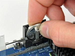

Okay, I just had one more idea come to mind, maybe it's the battery? Here's why, I have an iMac G3, and when it was around 4-5 years old it had the PRAM battery die and the symptom was that it would do nothing. Just like it wasn't getting any power. I replaced the PRAM battery, ($12 from Radio Shack) and reset the PMU (the SMC on newer Macs) and I was back in operation. I know that the usual symptom of a dead battery is that it doesn't remember the date and time (my current iMac G4 has that symptom but still boots) but with the iMac G3 it was effectively dead from the dead battery. Maybe the same is true of your mini. It's the only thing I can think of besides a trip to an Apple Authorized Service Provider at this point.
Hmm, good idea. Is it the little silver battery standing upright inside of the Mini?
Yep, it's a button battery in a little black holder:
1xlKQAdcwKWC61Av.standard
iFixit: Installing Mac mini Model A1176 PRAM Battery
P.S.: You might want to correct your sig, according to :apple: Apple: Mac mini (Early 2006) - Technical Specifications your mini is an Early 2006 not 2005. :)
No :( the PRAM didn't work. Got the new battery at Radioshack for $5. I don't know what the hell to do now.
