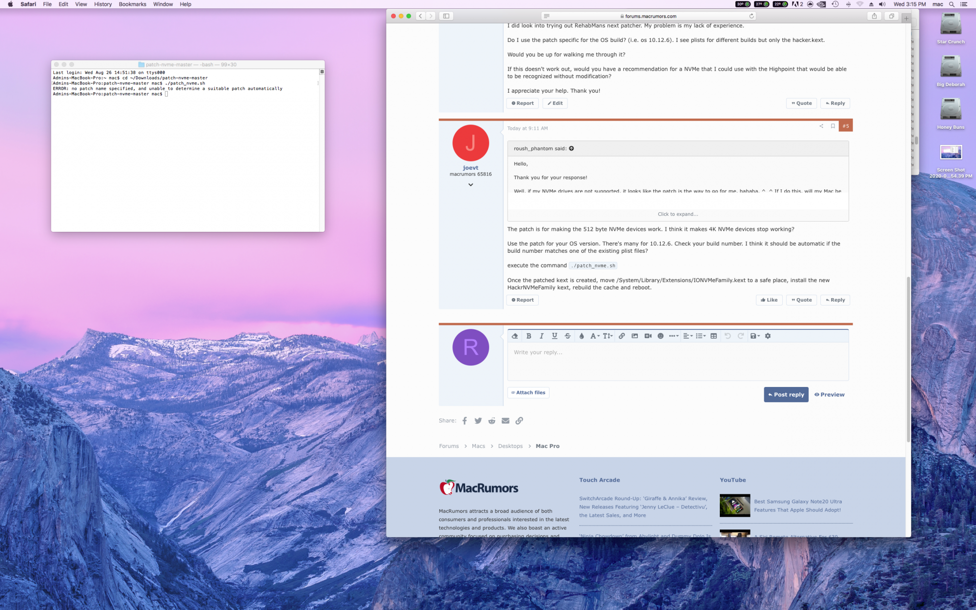

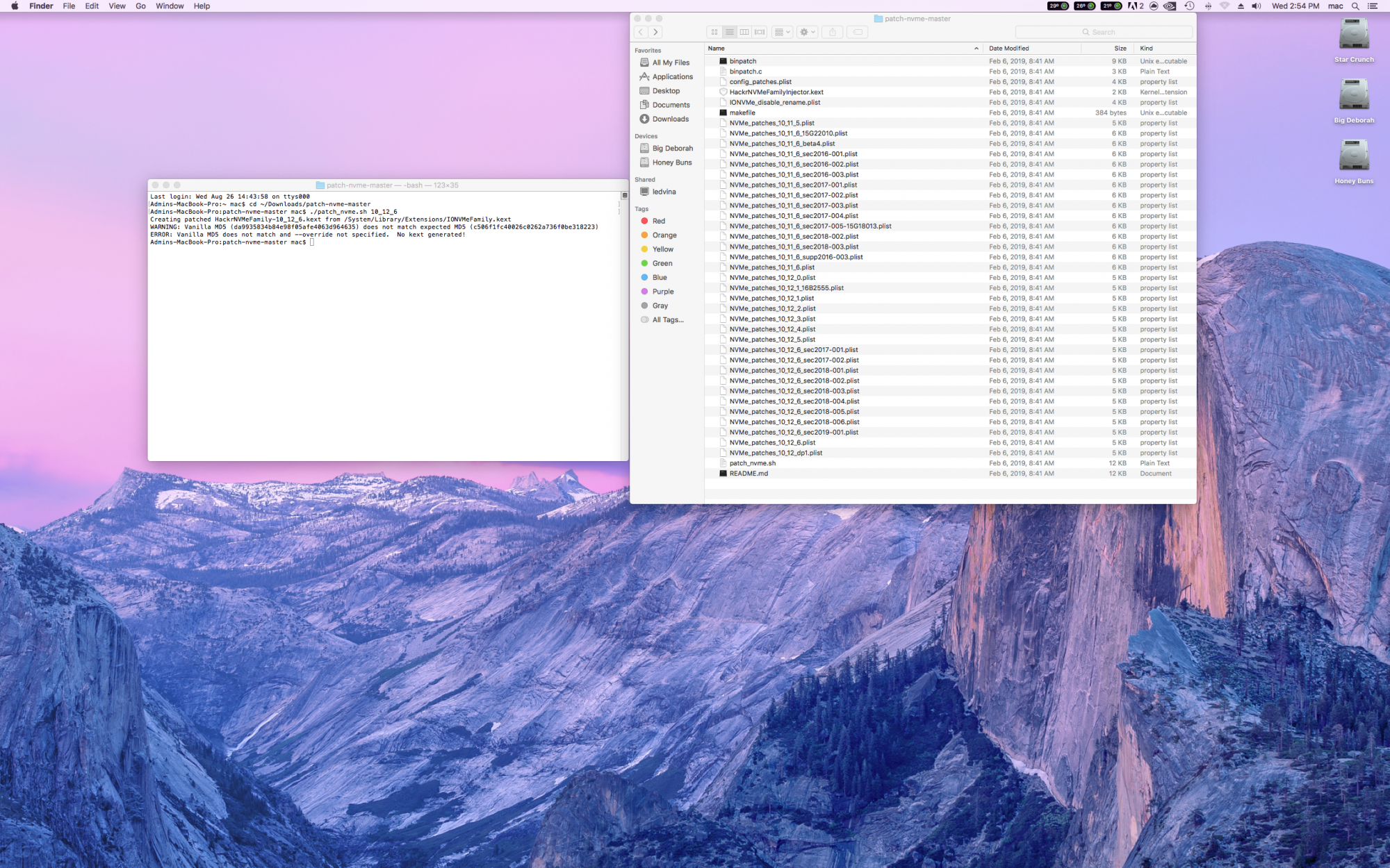

Hello,
I'm including a few screen shots for you to reference. So far, no luck. Hopefully, with just the right push, I can make this happen.
Thanks for any advice! ^_^

Hello,
If you examine all the NVMe_patches_10_12_6* files, you can see that they all have the same patches, just different MD5s for the unpatched and patched kext. Therefore, it is probably safe to just add the --override flag to force the creation of the hack kext.
./patch_nvme.sh --override 10_12_6
