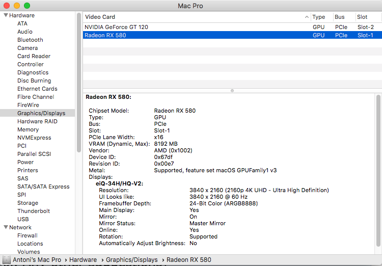

Okay so I have both plugged in like you said, and when I switch the HDMI ports, only the Nvidia one is connecting to HDMI 1, when I switch to the Radeon which is plugged into HDMI 2, its still saying "no signal". I have tried both display port and HDMI and neither of them seem to connect to the monitor. Any other suggestions?
The good news is that the Mac has recognised that I have plugged in the Radeon and its seated correctly so it is seeing that the radeon is there as a graphics card yet its not connecting to it when I switch to that HDMI port where it is plugged into. This is really strange now!

Its okay I fixed it, finally! I managed to switch between the mirroring windows using the arrangement tab, in the displays settings on system prefs. I also toggled between the various resolutions and it seems that it works best on 3440x1440 resolution. Then, I unplugged the Nvidia card from HDM1, then plugged in the Radeon card in its place in HDMI1, and it seemed to work, The Radeon is now the card that is connected and not the Nvidia! Prior to this though I did a completely power off of the screen unplugged the power cable, for about 60 seconds, then replugged it back in and did as mentioned above. So thanks for the advice it helped me massively to solve the problem!
