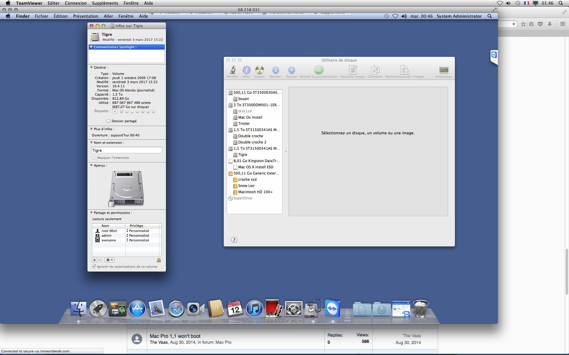

Jesus what a mess. Now they stay locked as in the image and I can only access them if I log as root in his mac pro.
How could I change these permissions to be recognised again by an ordinary admin account (not a root one)??
I try to do it with ignore permissions etc on this volume, it does not work. And I cant add a new user to the volumes, I click on the + symbol to add, I add it and nothing happens.
And in the admin(not root one) account he is not able to access the content of the volumes because he does not have the permissions on the volumes...

I figured out how to unlock the volumes with Batch mod and I reinstalled the OS.
One strange thing - I unlocked the OS volume before reinstalling and tried to boot on it but without success...
I do not understand how the TM volume could have messed up so much all the volumes
