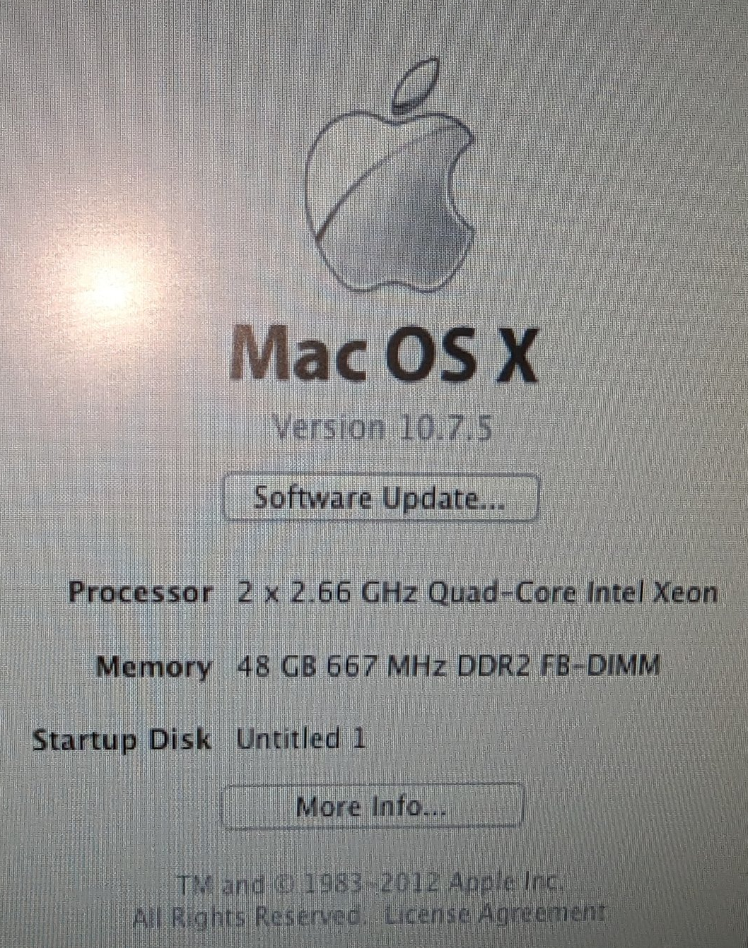

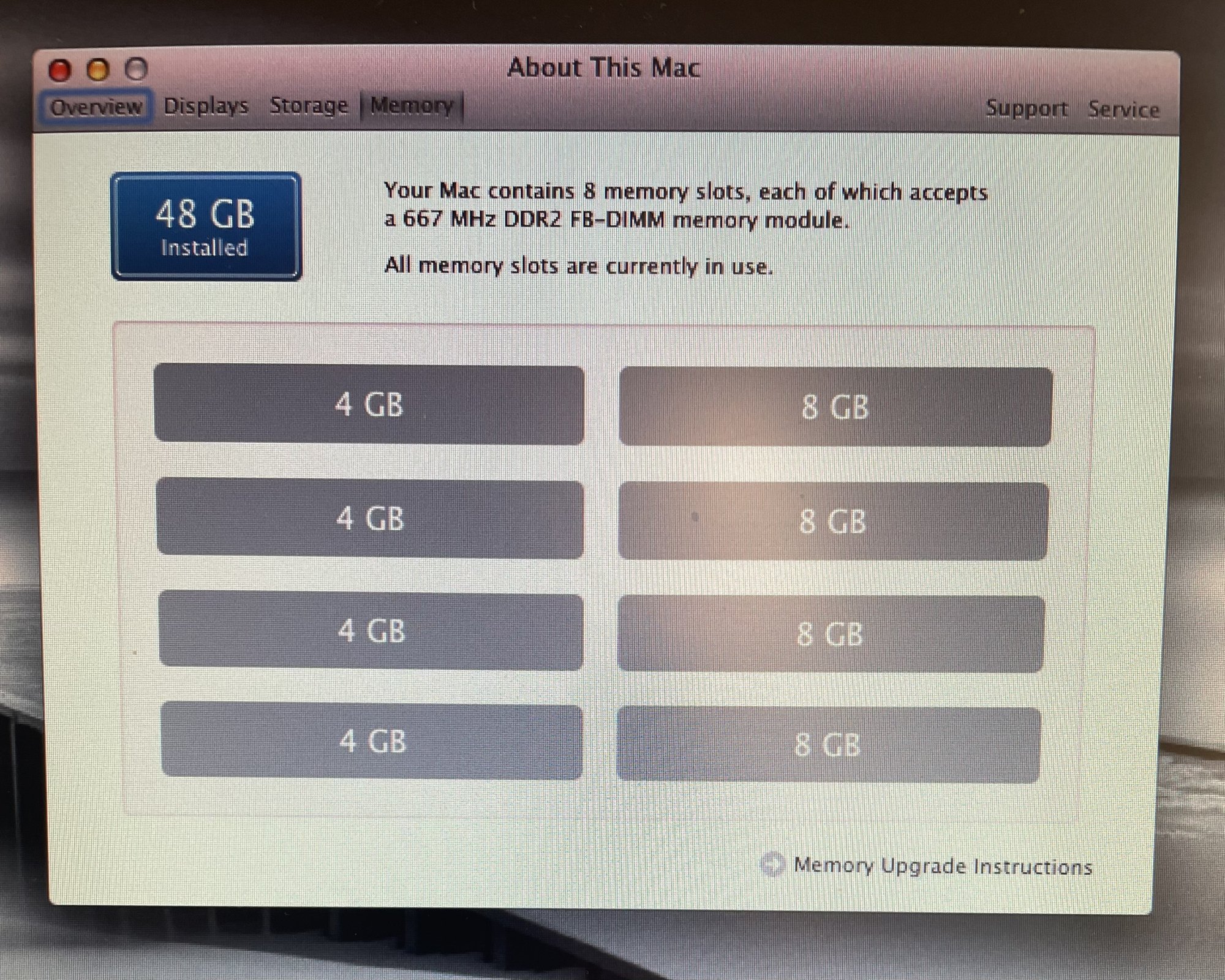

Mac Pro 1.1 upgraded firmware and the ram.
The firmware is now 2.1 and I now have 48 Gigabytes of Ram. These Macs will go all the way up to 64 and probably beyond with modification.

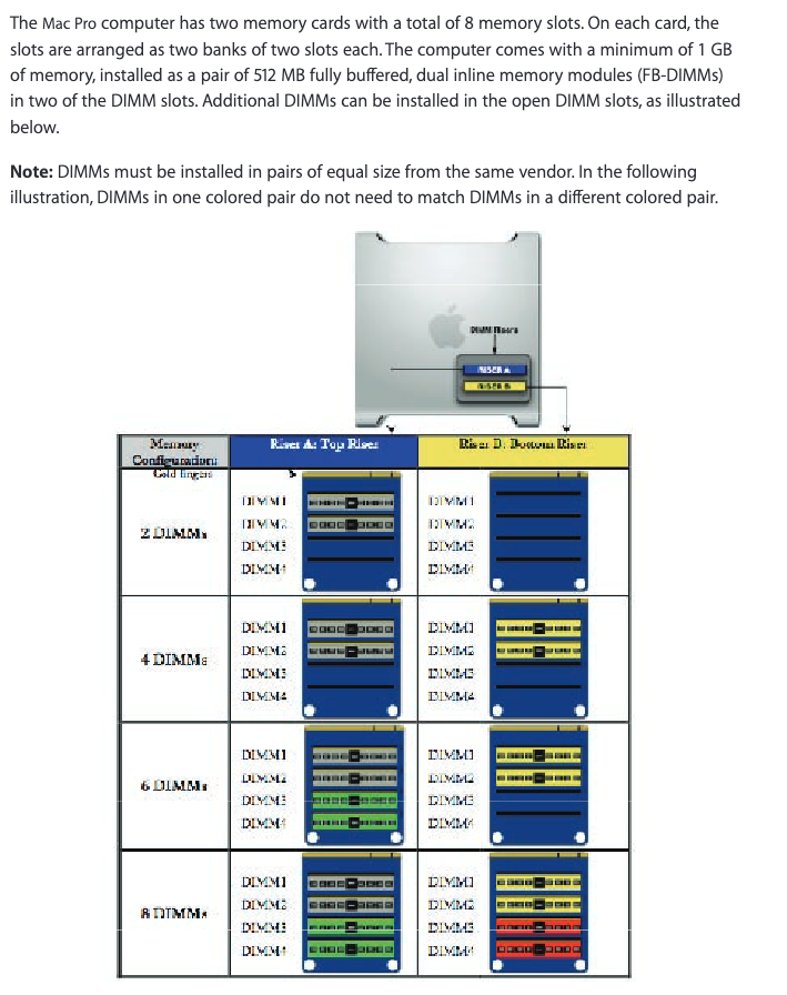

Moving the ram trays around causes OSX to be unstable, so is there a rule regarding positioning Ram, smallest then biggest.
simie
macrumors 65816
Aug 26, 2004
1,192
71
Sitting
As for today, the rules are pretty simple:
Use 8 sticks of the same type RAM.
I bought 8 sticks 4GB for 24$ (3$/stick), you might get them for free if you search from local junk shops.
The only reason that I moved the trays was that I needed to remove the Fans to get access to the SATA ports and the Mini PCIE port to install hardware, when I put the Mac back together I Put them in the wrong way round. This caused the MAC to freeze and crash, so swapping them back fixed the problem. My 48Gb@s runs fine now.

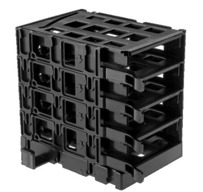

Perhaps buying a pre-made 5.25" to 3.5" adapter/bay is a better option.
Remember that SSD's are actually smaller than 3.5". I do have suitable brackets that I have installed to reduce to 3.5" but then realising that the SSD's are actually smaller.
