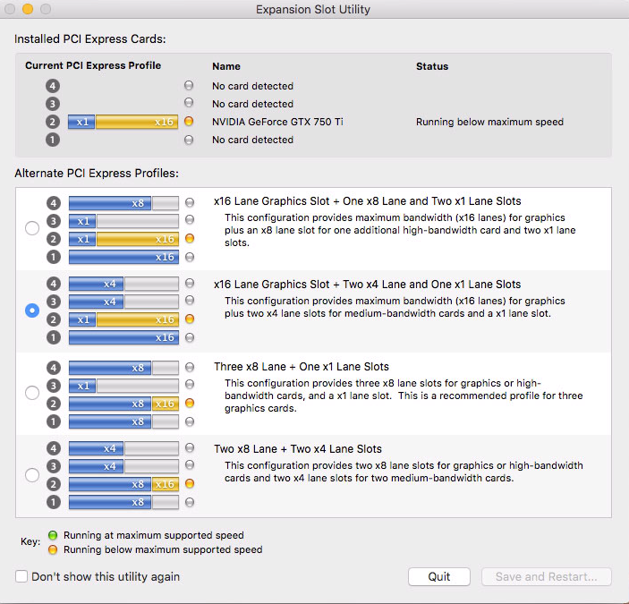

I can remote desktop into the mac, and this is what I see:
Single GTX 750 on it's own in slot 1 or slot 2
Single GTX 750 in slot 2 but set to 1x
I also want to mention that I have Bootcamp and Windows 10 installed, I cannot boot into Windows in the same configurations as I cannot boot into Mac, so, to me this indicates something with the way the Mac has the PCI express slots configured (via the utility).

Managed to get this working. The GTX 750 ti is in slot 3 (running at 4x) and the ATI 4870 is running in the original 16x slot.
I have a second display connected to the ATI card, this means I can flick between Windows and Mac from the boot screen and the GTX 750 is connected to the primary display.
All graphics intensive stuff runs fine from the 4x slot, it's a shame that it's being limited by the 4x, but it's more than enough for me, until I decide to upgrade to a more recent Mac Pro.
The only thing to mention is that you should not switch between Mac OS X and Windows using the Bootcamp option from the OS. Instead, turn on and hold option, then select the OS you want to be in. It seems that it updates the boot part of Mac OS X when you do the latter, and this causes the Nvidia web driver not to load, meaning you have to re-install the drivers again.
