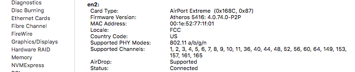

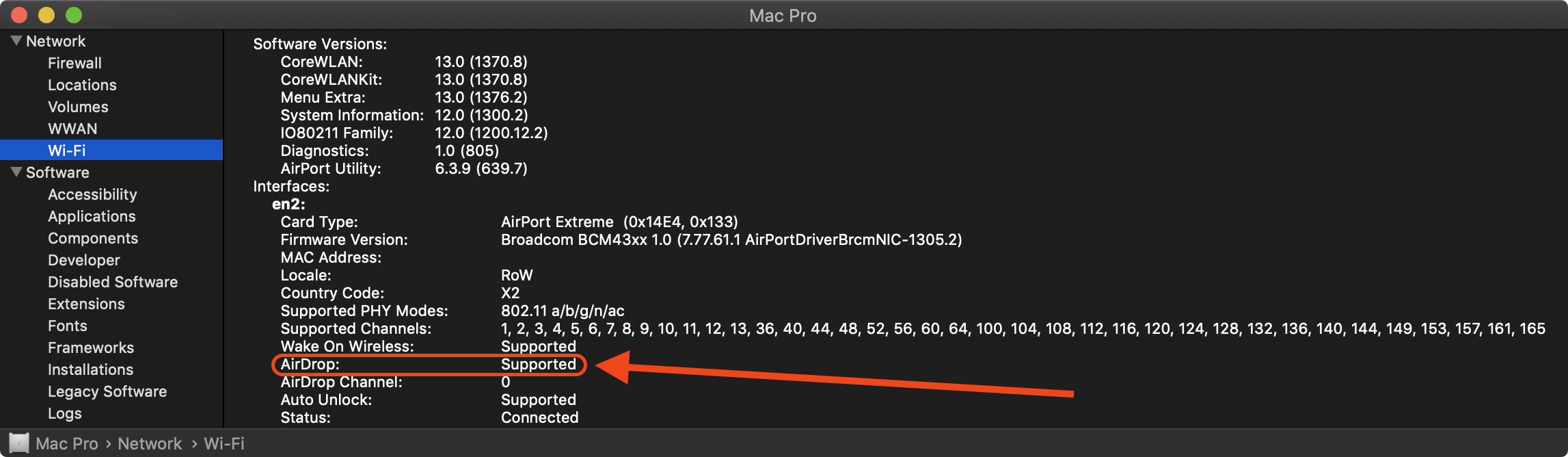

I have a Mac Pro (Early 2009) flashed to 5,1 WITH this
AirPort Extreme (0x168C, 0x87) card.

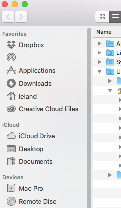

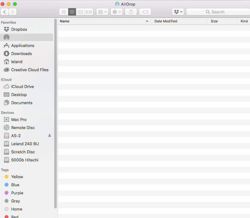

When I look in the Finder I can see the AirDrop icon (the round concentric circles icon) but it doesn't say AirDrop next to it. When I click on it and open it, it does say AirDrop, but I can't connect my laptop (a MBP Late 2011).
Any suggestions as to how I can get this to work? I've seen a lot of people trying to connect to iPhones or iPads which I know may need updated bluetooth (?) but I just want to connect to my laptop...?
Thanks,
Alan. Screen Shot 2019-02-03 at 9.39.40 PM.pngScreen Shot 2019-02-03 at 9.39.58 PM.png

I tried this but no success, still have the AirDrop symbol only (doesn't say the word "AirDrop" in the finder sidebar). I tried to put a document in there but it said "Modifying “Hard Drive” requires an administrator name and password"...when I click "Authenticate" it says something like "you can move this to AirDrop but you won't be able to see it. Other users with sufficient permissions will be able to use them" (or something like that)...then if I click OK, I get an Error -8058...

I don't think that's a supported card. Simply put the cMP in the white list (that terminal command) may not be enough.
Did you try CAT yet?

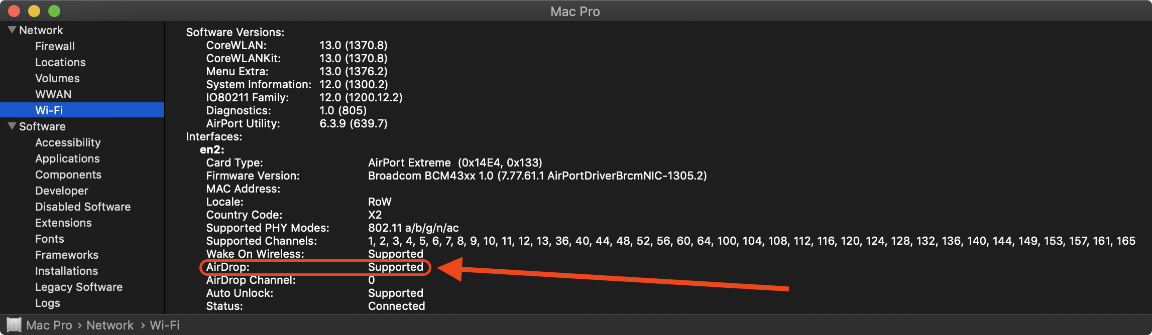

Hmm...but did you see the screenshot I posted? It says card is supported?
Also, not sure what you mean by CAT (I may be out of my depth here in terms of my computer savvy!)
Thanks,
Thanks,
Continuity Activation Tool
https://github.com/dokterdok/Continuity-Activation-Tool/tree/beta
I suspect you mod the kext which confused the OS about supportability.
AFAIK, that command should be used for natively Handoff supported card e.g. BCM94360. But not make non supported card provide those new functions.

"Atheros Wi-Fi AirPort cards will prevent Continuity from working even when adding a Bluetooth 4.0 dongle. The System Diagnostic feature of CAT tells which Wi-Fi brand is active. There are no workarounds and no patch is expected to change this, an AirPort card upgrade is required."
Straight from the CAT site, looks like you need a new Airport Card if you want continuity support or Wifi support in newer MacOS versions. Atheros cards befuddle newer versions of MacOS.
