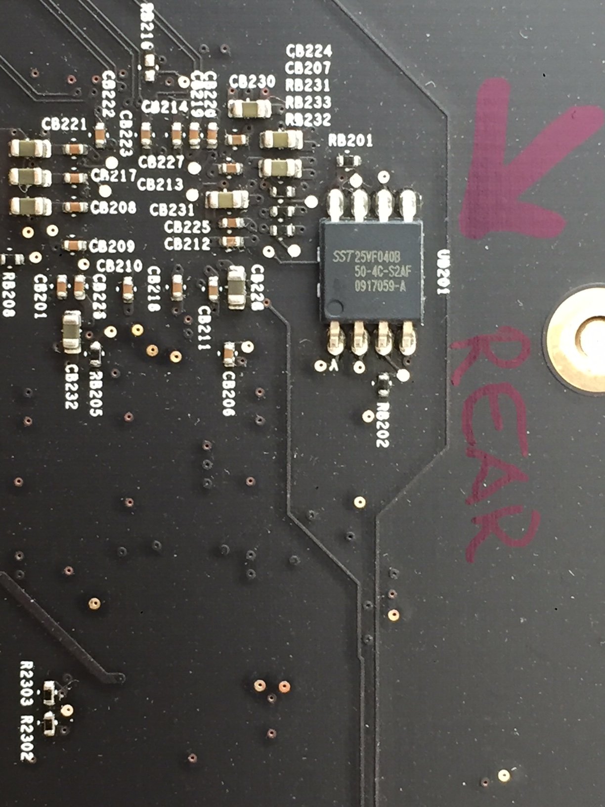

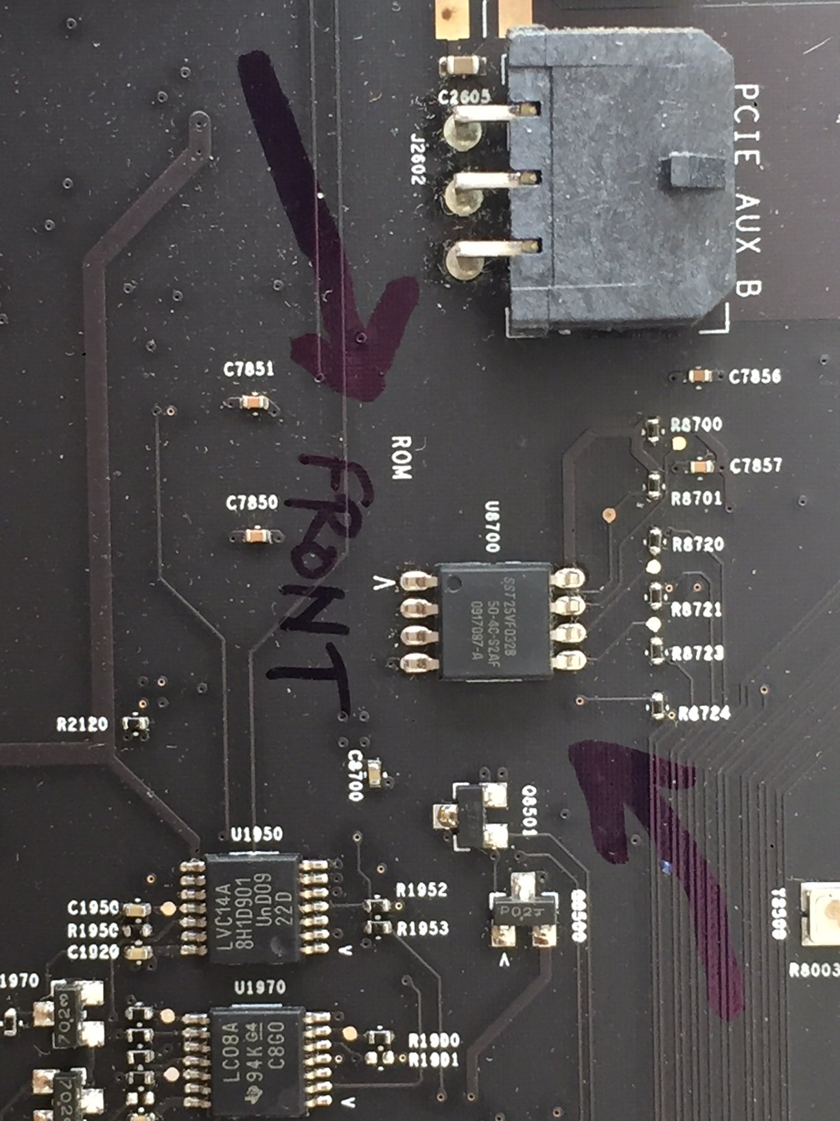

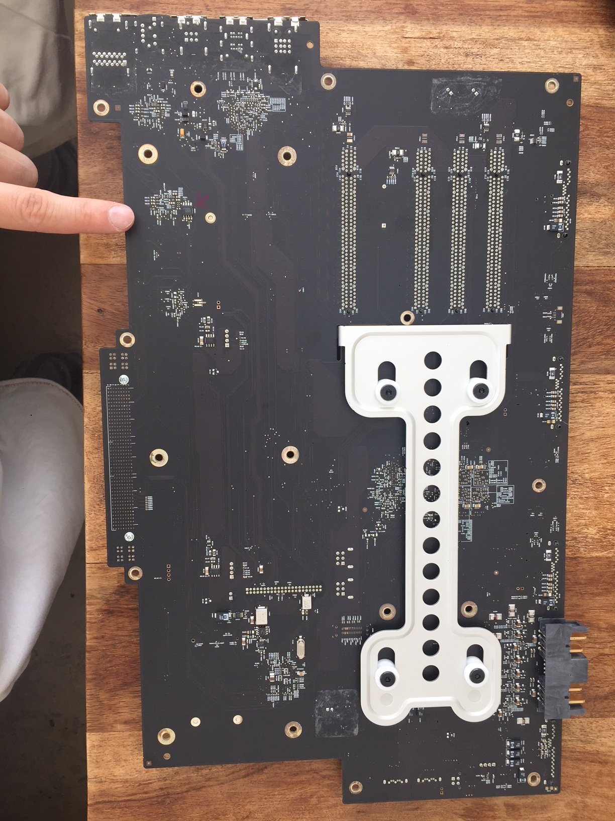

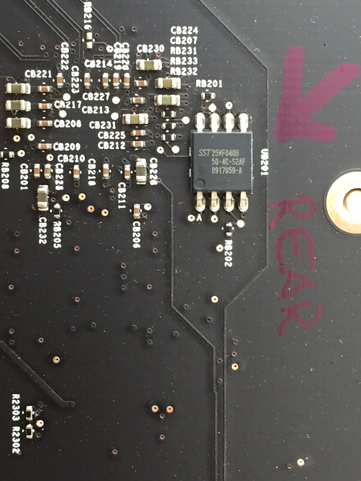

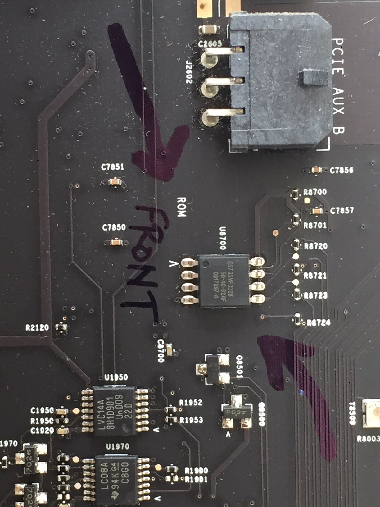

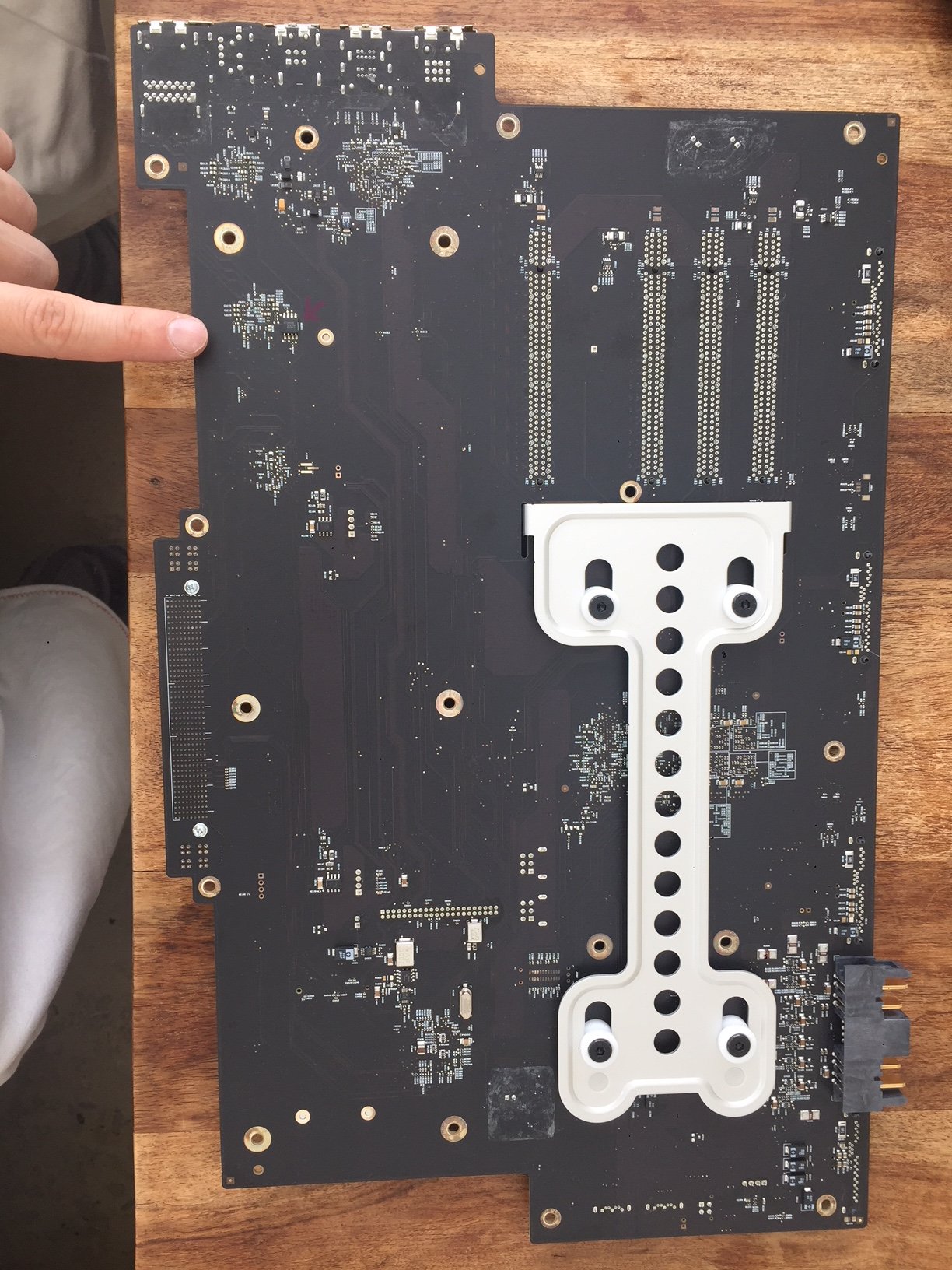

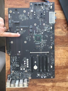

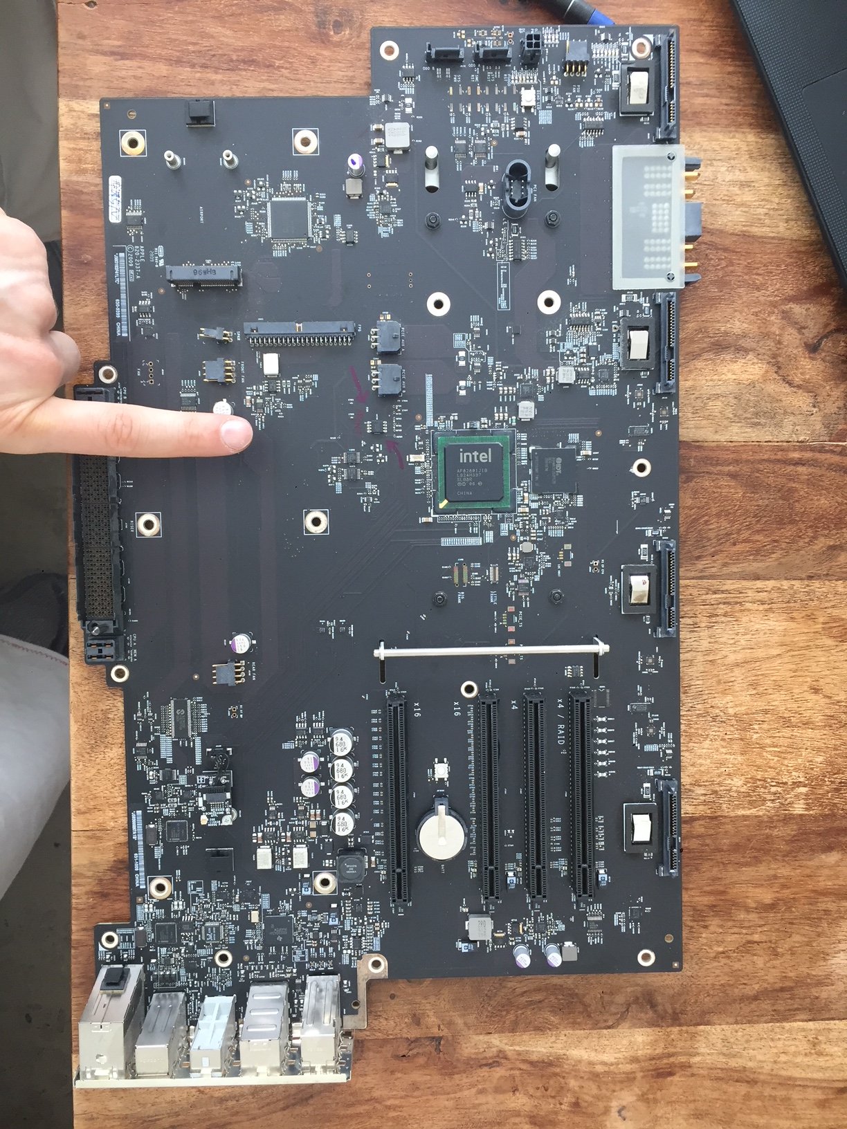

This is the ROM chips that is located on the board. Images are for everyones information / orientation.
If anyone knows which one of these ROMs are the EFI and what the other ROM is i would be happy to have som input.
Seems there is SST chips with the SST 25VF032B 50-4C-S2AF (front) and SST 25VF040B 50-4C-S2AF(back) markings. These chips can be found on ebay.
032b ebay
032b datasheet
Some info on programming
040b
040b datasheet
programming tool
SST 25VF032B (U8700 front) is the SPI-flash memory that stores the BootROM.
SST 25VF040B (U8201 rear) is the SPI Non-Volatile Memory Interface for the Intel 82574L Ethernet controller.
