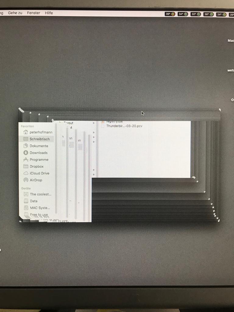

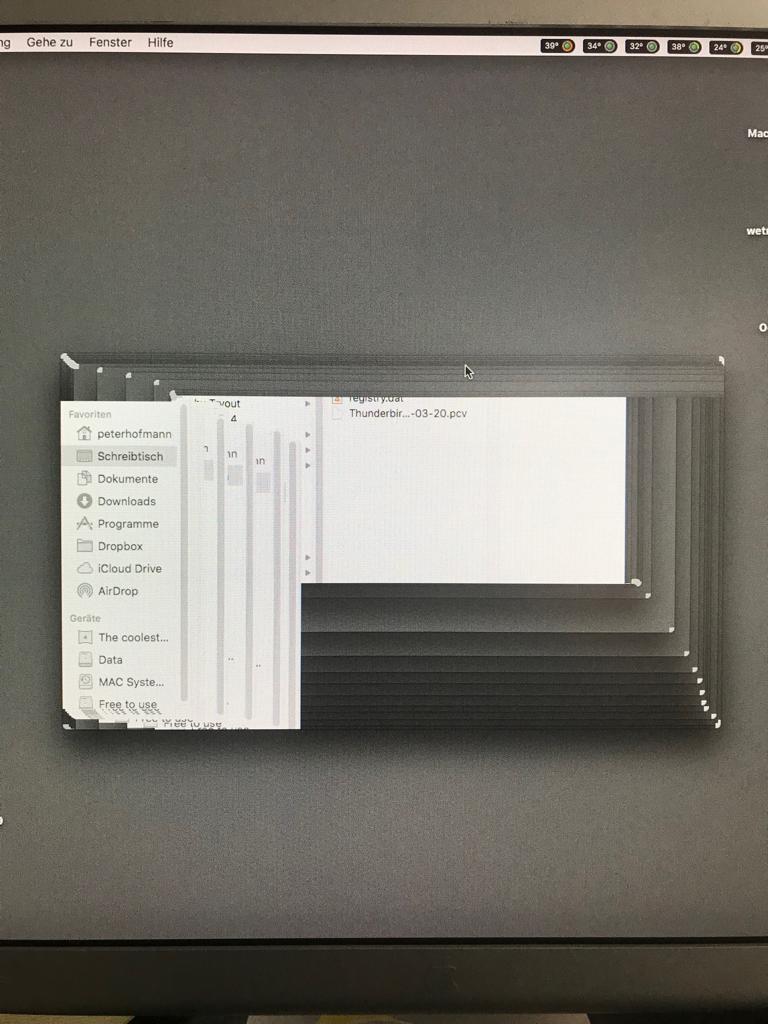

My Mac Pro is from 2009, flashed to 5.1. Running two GPUs, an ATI Radeon HD 5770 and a ASUS Turbo GeForce GTX 1070 TI. In OSX The Radeon works fine but the GeForce has weird display errors (See the images attached). The strange thing is, that the GeForce runs normally on the Windows partition.

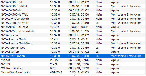

"NVDAStartupWeb", "GeForceWeb" and some others are loading now.

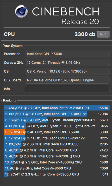

Hi Rudolf, great ! I think I’ll move forward with High Sierra ....
Can you do a benchmark for your 1070ti ?
I’m curious to see your benchmark score.

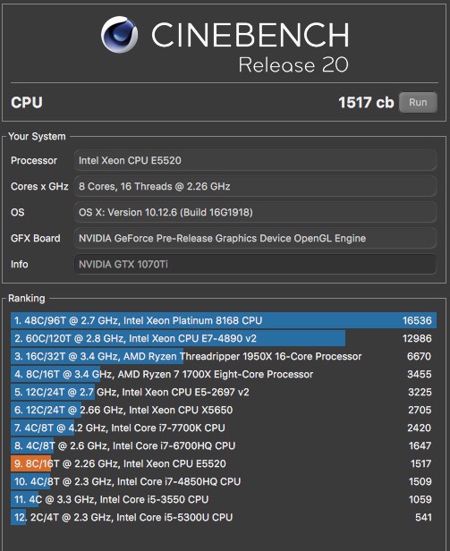

Here is my benchmark.
Yeah, I was too busy to dig myself into GeForce GTX 1070 with Mojave in a MacPro. What I read after the release was that it might be problematic. Was already a pain to get it running on High Sierra, so Im a bit afraid to touch it:)
This is my benchmark, hope it helps you.

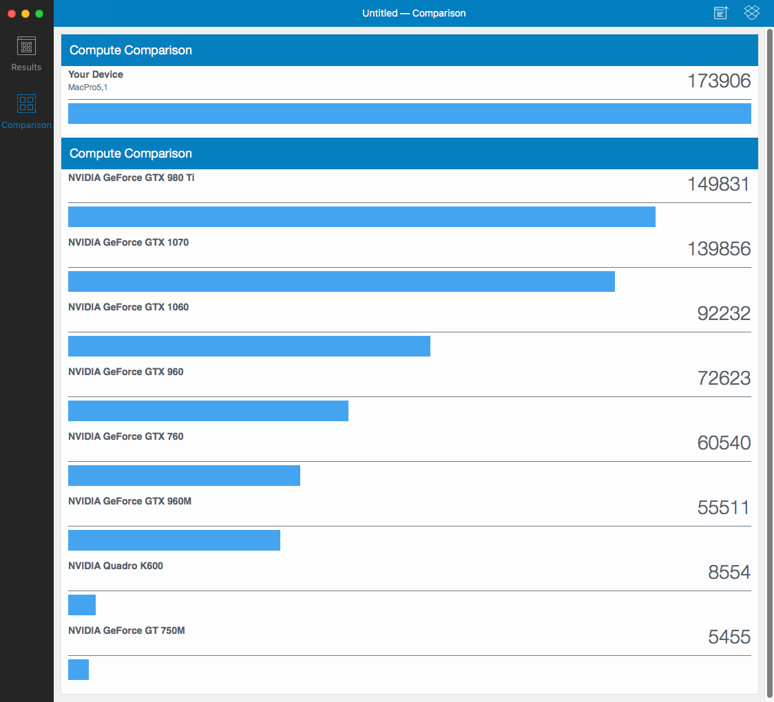

Oh, you are right! Thanks for the hint @IndioX
Here is my benchmark with Geekbench:
